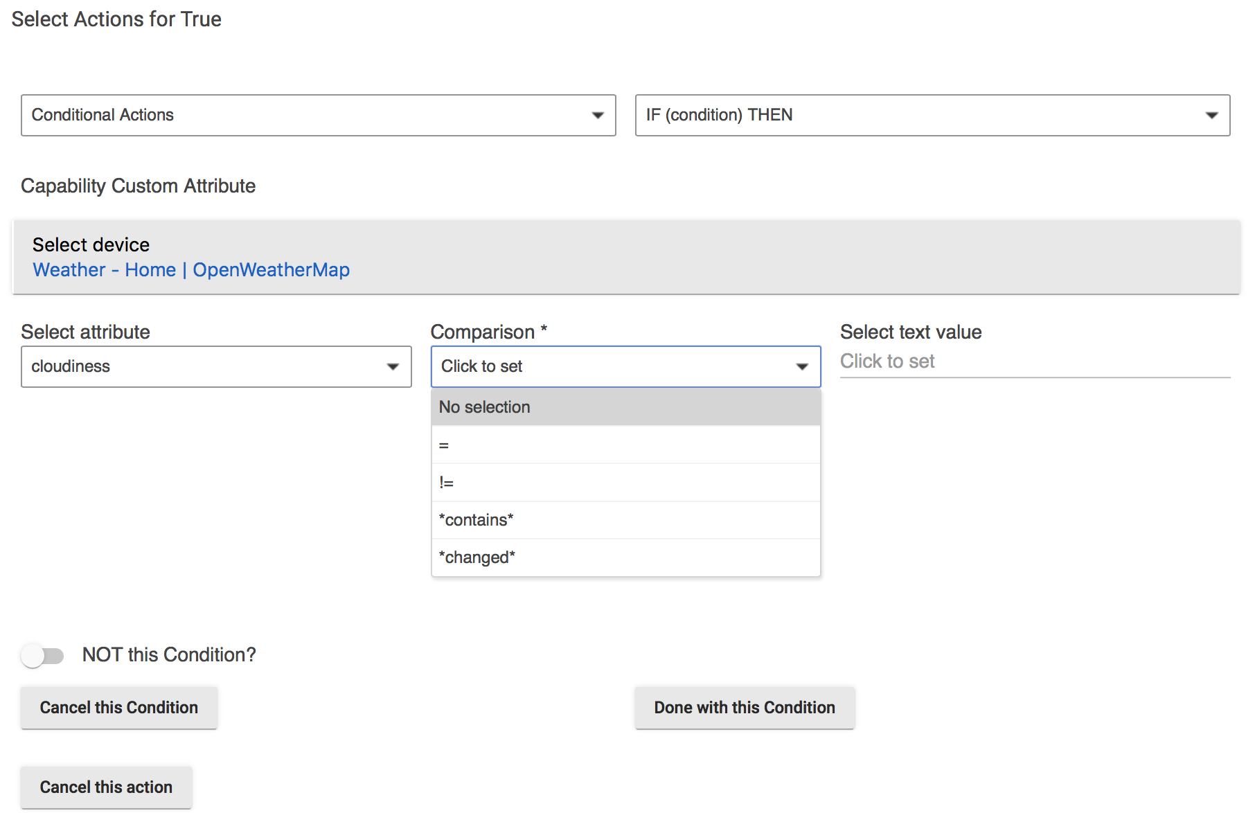

Is there anyway to set a global variable to open weather attributes not listed as sensors such as cloudiness? have no issues with setting variables from temperature or humidity, however, attributes which are not common too many devices are not available in the select for sensor type when setting values in rules machine.
as long as that attribute is exposed in the driver correctly you can use it as a action or a condition (depending on what it is obviously cloudiness can't be a action), so i suspect you need to reach out to the developer to ask the driver to be corrected. IE below
thank you borris, it is for the Open Weather Map driver which I believe is a hubitat created / supported driver. haven't been able to find any way to set a global variable to the cloudiness value or implement as needed in a rule. you can select the virtual device created for the OpenWeatherMap driver along then with custom attributes to use in a rule conditions as you captured in your response, however, are limited to comparison operators of =,!=,contains, and changed. same goes for if attempting to use in action conditional actions. Possibly assigned as a string rather than numeric based on those operators and no ability to assign its value to a variable. will look for support of OpenWeatherMap driver.
Not sure if i'm understanding you correctly but if i am you want want when a the driver "changes" its cloudiness value you want this to represent in a GV?
So what about a trigger for when custom attribute "changes" set GV X to ?
If so it looks like your need to request it as a feature as it does not currently seem possible
that's right where i'm at. have a trigger built already looking for changes in value. stuck here trying to extract value.
tried to go a different route using a rule to assign a variable value based on ranges and can't make that happen either unless i get in the mood to create a boat load of conditional statements
grabbed an api for apxi and added csteele's wx-ApiXU-Driver.groovy driver in. run into same issues. can't pull those custom attributes out when looking to assign their values.
Will be able to make a work around with the APXI driver cloud attribute as it's comparison operator selection contains the full list of operators. If statement with use of >,<,>=, and <= comparisons operators to create ranges.
Looks like the cloudiness attribute in the OpenWeatherMap driver may need a type reassignment and possible new functionality request to extract the custom attributes for assignment to global variables...unless i'm missing something yet
