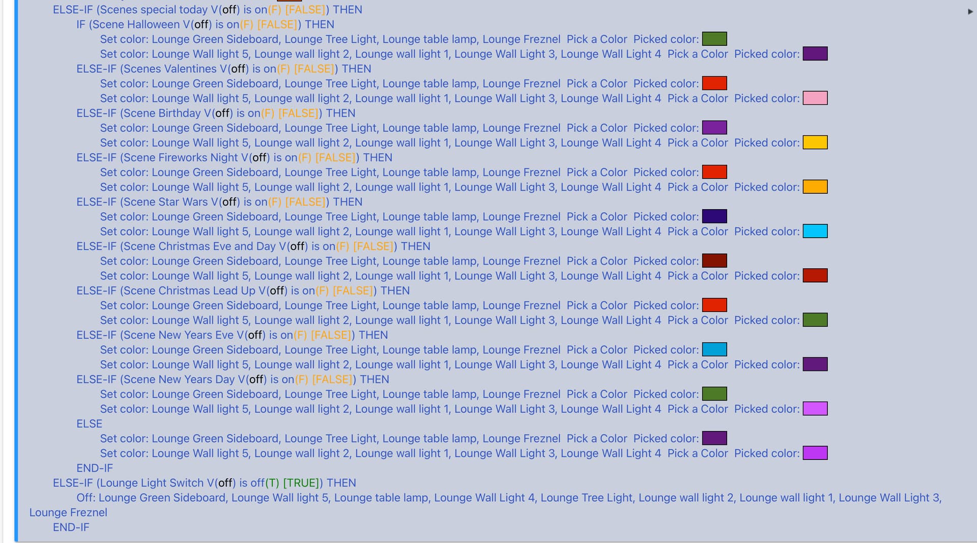

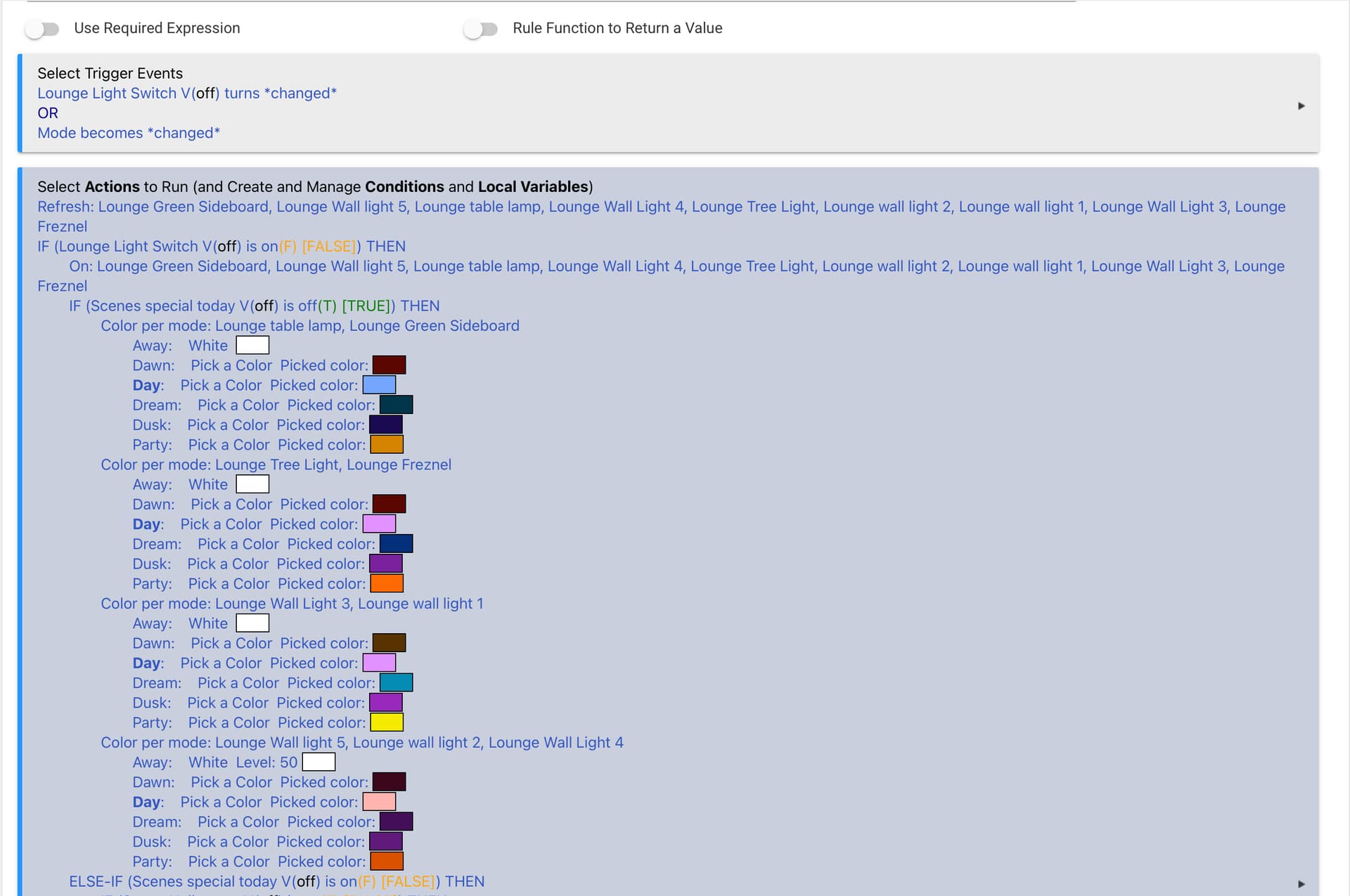

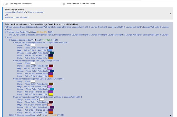

I have added some screen shots of the rule I am currently working on. I am attempting to write a number of rules to replace my Room Lighting setup as I have found that it doesn't work unless a refresh is done on the lights immediately prior.
