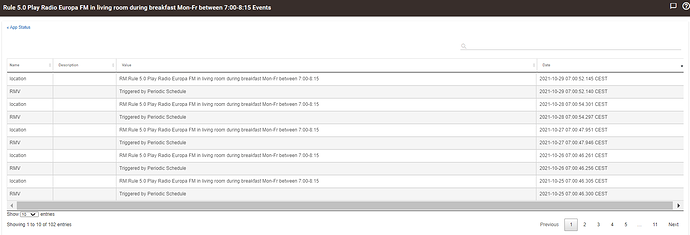

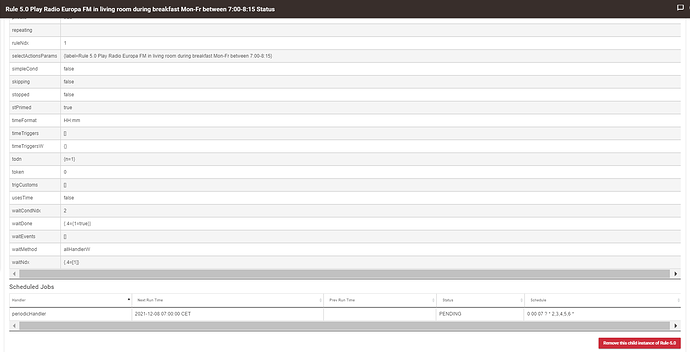

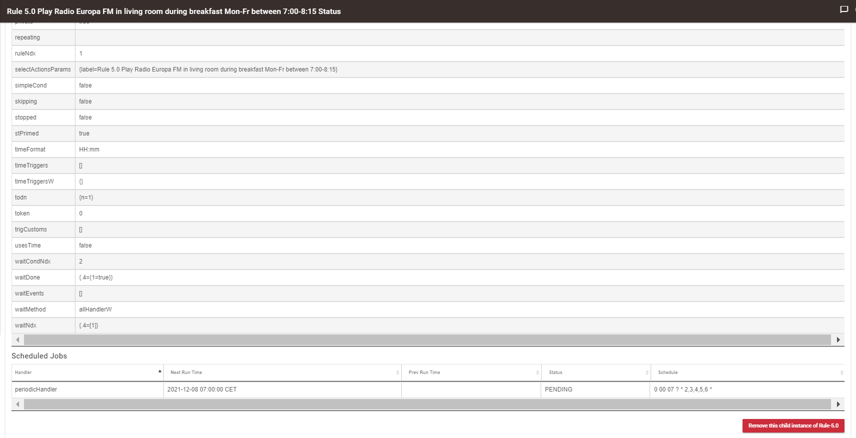

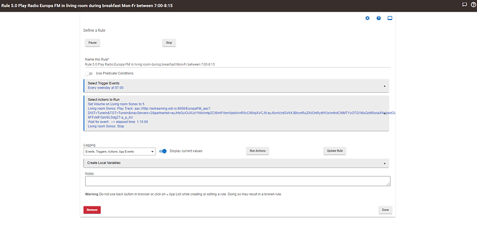

I have created a rule (rm 5.0) to play a certain radio station on my Sonos speaker every weekday at 7 o'clock. The rule has worked flawlessly till the end of October, but ever since it stopped suddenly without any reason. The log doesn't show any information and i can't figure out the reason why the rule is no longer run. Note that everything works fine when i test the rule via the "Run Actions" button on the rule card. Any clue on what's wrong? It rather looks like the rule machine misses the trigger. I also attach two images with additional info.
It's possible the scheduled job (every weekday at 7 AM) got messed up. If you're curious about that, the "Scheduled Jobs" section on the "App Status" page (gear icon towards the top of your first screenshot) will show you. You should see something there, likely with a cron string that reads something like "0 0 7 ? * MON,TUE,WED,THU,FRI *" (for every weekday at 7 AM--but don't trust me exactly on that!).
It is likely that just hitting "Done" (at the bottom of your first sceenshot) will fix this. It will re-schedule that job. Even if you do see something like that scheduled already, it can't hurt to try either way.
I was hitting the "Done" button and tested the action a million times during the last month. No success so far and the issue is driving me crazy. The job is shown as being scheduled properly, but nothing really happens when the time comes.

That said, I tried "http://astreaming.edi.ro:8000/EuropaFM_aac" and the stream worked. Do you need all of those parameters in that very long URL?
Maybe try simplifying it to just "aac://http://astreaming.edi.ro:8000/EuropaFM_aac" and see if it works.

Thanks roofone! That was my first thought as well, but the url has always been working (i tried it in a web browser countless times). In the rule i used the entire url as displayed by the device in the HE and never had any issue with it. If i test the rule by clicking on the "Run Actions" button everything runs smoothly. The rule is scheduled to be run every weekday at 7 am, however the log is always empty. I would say that this is an obvious sign that the rule is not triggered...but why is the rule not triggered? I have a C-7 hub, software version 2.2.8.152. I didn't update the software or installed any new device since august, thus i don't really understand why all these bugs.

Yeah, no ā€œprevious run timeā€ in the Scheduled Jobs either.
