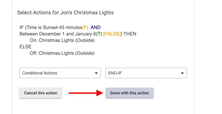

Hopefully I have attached a screen shot of the rule, if there is any more information you need please let me know.

Further to what @razorwing posted, if you want to limit by date, this will work. It's not nessecary to evaluate again before off, since that will be done at 45 min before Sunset and at 11:30 PM. If the time is Sunset -45, and the date is between December 1 and January 6, then the lights will turn on, but if it's not either of those and it is 11:30 PM, then they are going to turn off. So you can just use ELSE in this case.

If you wanted to break it down so you can maybe understand it better then you could do this. This is the long version and maybe once you understand this then SmartHomePrimer's will be shorter but do the same thing.
IF time is sunset-45 and
between dec 1 and january 6 then
on christmas lights
elseif time is 1130 and
off christmas lights
endif
OR
2 IF statements within the same rule.
on christmas lights
endif
IF time is 1130 and
endif

Your action needs to be "Conditional Actions", then you can input the condition after IF and then the action that will take place after THEN
Here's a step by step (granted, it's a lot of steps for such a simple rule, but that's the way conditional actions in RM 4 are handled). It's not hard, but it does involve more clicks than I would prefer.
