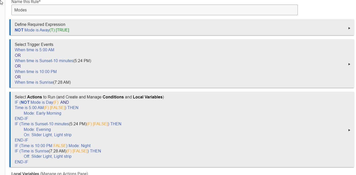

I just manage my modes with Rule Machine. It's easier for stuff like this.
I don't have a set schedule so I use switches to trigger modes. The only mode that changes based on time is Evening, which triggers at sunset. In the morning, "Alexa, good morning" has Alexa turning on Switch - Day. When I go to bed, "Alexa, good night" has Alexa turn off Switch - Day, and this triggers the Asleep mode.

Here is how I have mine currently. If you want it to always set the correct mode you'd need to expand the logic to have an appropriate trigger to do the evaluation (maybe a virtual switch) and then expand the IF statements for ranges of time. But it could be done.
As a note my system is put into Day via Alexa and into Night and Early Morning most often by Alexa.
