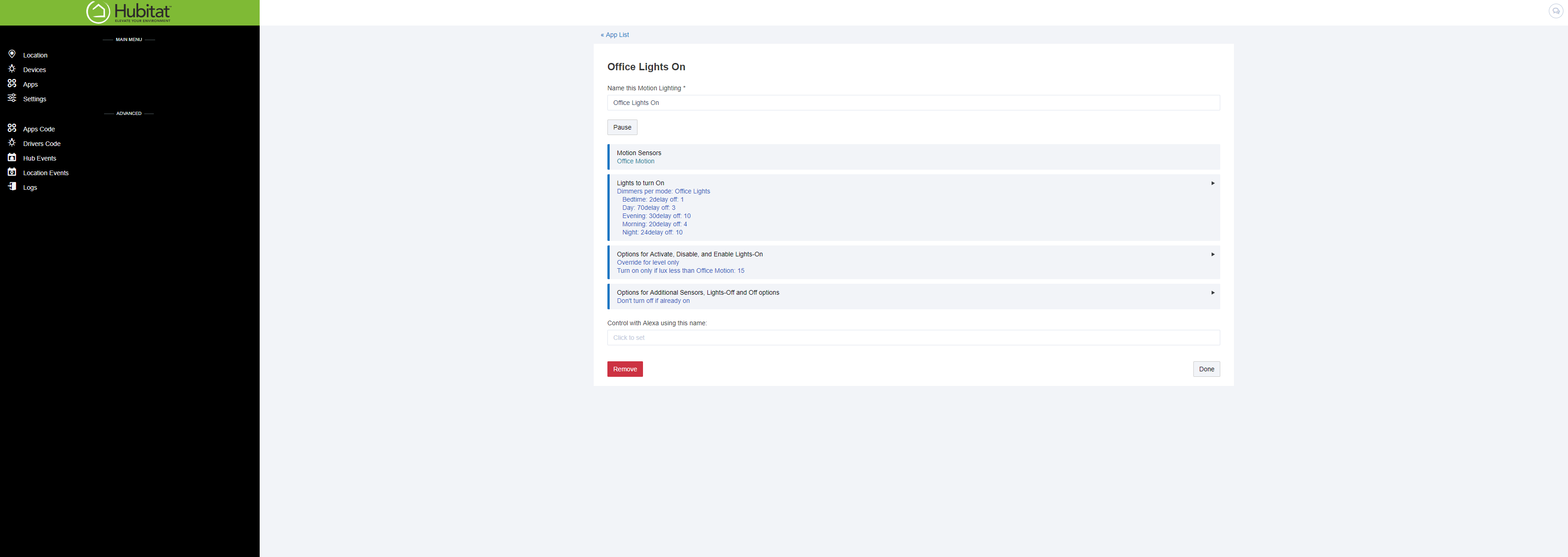

As an example here is a motion lighting app I have configured. The way this should work is that motion events active/inactive should obey the rules I have set in this app. But if I turn on the light manually then I want the light to stay on. Also if the lights are already on from a previous motion event and I change the dim level, I want that new dim level to persist until the lights turn off.
