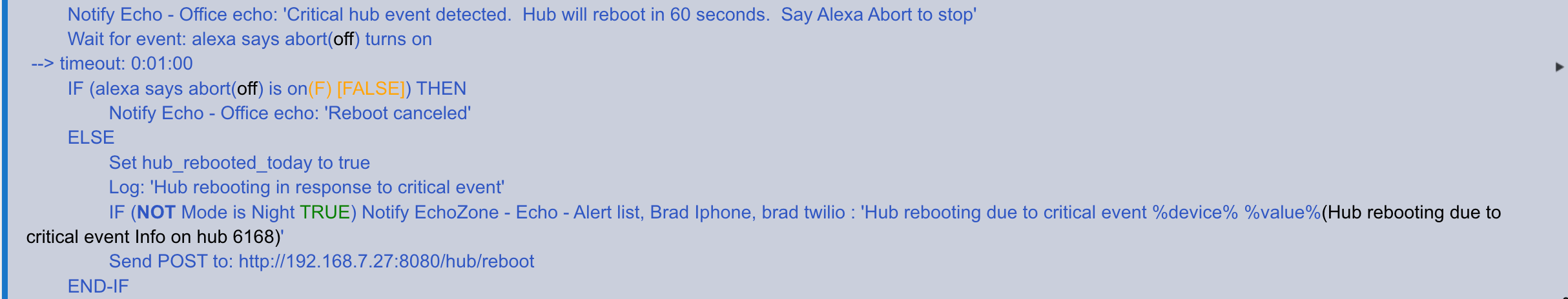

In the mean time here's a little RM snippet that does something similar. Gives users 60 seconds to halt a reboot by flipping a virtual switch via Alexa. Maybe it will be helpful until you can upload your rule.
