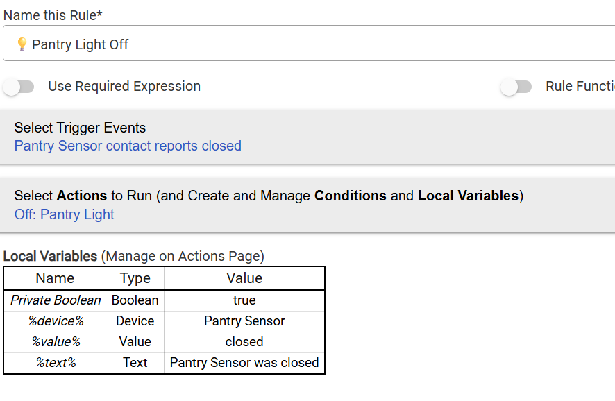

I am running a C8 pro and have started experiencing some delays. In the example below, it shows a contact sensor that monitors a door open state then activates a ceiling light accordingly. The sensor is a full minute before the light switch (controlled by rule machine). Any ideas why the delay is so long and where I should troubleshoot?

Your log indicates that the issue isn't with the Rule. The rule calls for off() at 3:01.21, corresponding to when the sensor reports closed (3:01.20).
However, your switch actually turns off a minute later at 3.02.20, indicating an issue with the switch responding to receiving an off() command. What technology does your switch use? If it is z-wave or zigbee, how robust are the z-wave and/or zigbee mesh networks?
If it is a WiFi switch, how is it connected to Hubitat?
