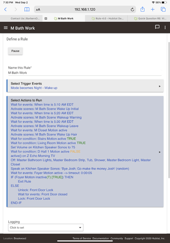

I’m kinda new to building rules. I built this rule to trigger scenes based on times. It will also turn things off when I get to a certain part of the house. If I go to the foyer it will unlock the door. If I don’t, it will just end the rule. What are y’all’s thoughts? Is there a better way to do what I am trying to accomplish?

This is my routine. It is built in order. As time flows it triggers the next scene. I eventually get to the point that isn’t as time specific. I still follow the same routine so I use motion sensors to trigger the next scenes, and speech commands as well as turning the TV’s nd lights off. I used rule machine for simplicity for a one stop shop for prepping for work. If I wanted to change something I only had to go to one spot. The biggest thing I’m hung up on is the end.
If I go into the foyer I want it to unlock the door and lock it back when it closes. If I don’t go into the foyer I just want to end the rule. I used a timeout and then a conditional action. I couldn’t figure out a better way to do it.
I would just change around the logic you have
Wait for foyer active > timeout 5 min
If foyer active
Unlock door
Wait for door close
Lock door
No need to exit the rule it will run the if statement or not.
Ok. Thanks for the help. I made the change.
