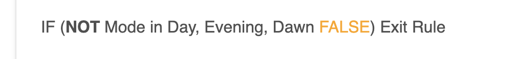

However, I'm wondering now if I didn't miss something here... Where would you add the conditional statement you just quoted? At the end of the app as a separate statement? So far I was assuming I'd have to create a mode condition, add it atop of all other conditions and indent it so all other conditions / actions would be within this first statement enclosure...
If it'll be a matter of just adding the statement anywhere or at the end of the rule, it's then a much simpler solution already, although it still needs editing.
It comes first, the very first action. It's a Simple Conditional Action. It is also very easy to edit, easier than to create.

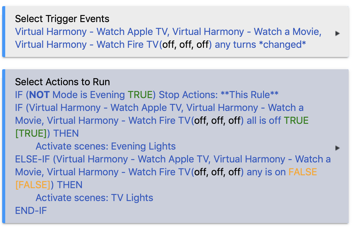

Apparently I'm not understanding how "Stop Actions" works. I assumed that, in the below rule, the rule would exit if it were not Evening mode and the IF statement would never be evaluated. But that's not what's happening. The IF is evaluated regardless of the Stop Action, and the lights get changed if any of the Harmony actions specified are current.
I can change the Stop Action to be an IF statement, but I'd like to know what I'm doing wrong, here. Thanks.
Don’t use the “Stop Actions: This Rule” action. You have to use the “Exit Rule” action
