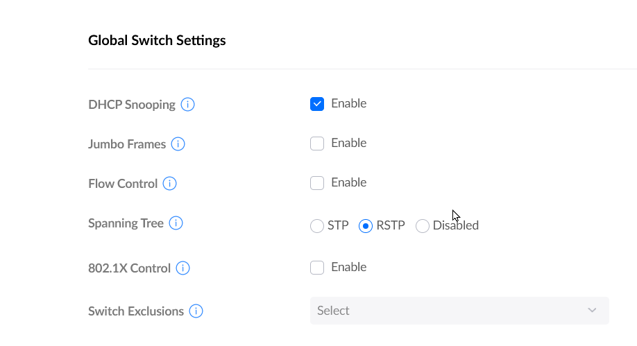

Do you have jumbo frames turned on, in your router? If so try turning it off.

Jumbo frames aren't enabled.

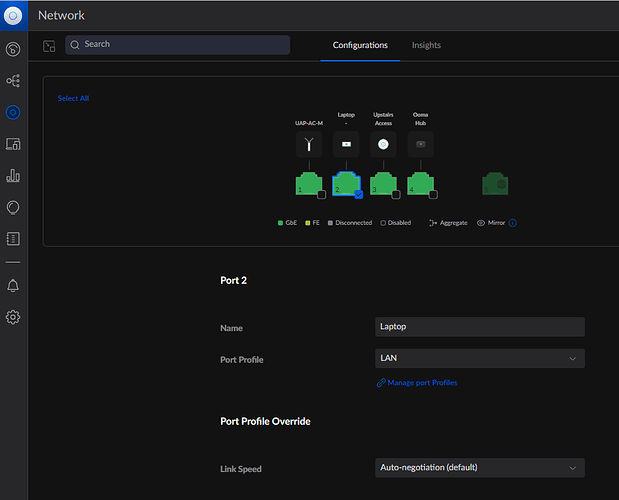

Gotcha. Port Management shows nothing connected then?
Edit: Could have worded that better. Port management shows nothing plugged into the port that the C7 is plugged into?

The port management page just shows my server.
I've seen that client list be very slow to update that is why I was thinking the port screen might be a better place to start.

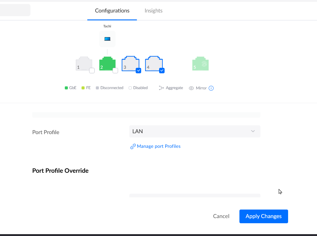

Maybe start by picking two ports and having them configured with the same profile. Then turn off wifi on the laptop and plug it into one the ports you configured. Plug the C7 into the other port you configured and give it 10 minutes or so. Then check port management and see if they are both showing up as connected devices.
If that doesn't work could try some reboots. Start with the UDM, then when it is up the laptop, finally the hub.
I configured both ports just to LAN.

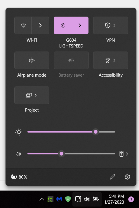

I ethernet connected my laptop and turned off the wireless. After that I went to http://findmyhub.hubitat.com/ and looked up the mac address. Nothing came up.
