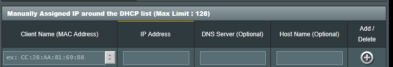

My ASUS RT-BE86U has a max limit of 128:
I believe the RT-AX86 and similar before it started life at a max limit of 64 and later moved to 128 as the firmware was updated.

Manually Assigned IP around the DHCP list (Max Limit : 64)

ASUS has it on all the routers AFAIK. Its somewhat of a UI limitation, but also they used to store the data in NVRAM which only had so much room allocated for the DHCP. I believe they have since moved it to a virtual NVRAM that is on the JFFS so you can pretty much have unlimited until the UI limits you.
With the custom Merlin firmware you can get around it, but it looks like the AX92 is not supported.
