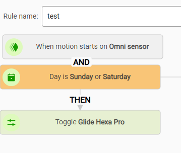

With the simplicity of that ask as well you could also just use Visual Rule Builder. Here is the rule that will turn on the lights on the specified days.
Then just create the opposite rule with the trigger being motion stops as shown here
That would do it, but i was also just playing testing this out in RL and it looks like if instead of choosing modes you select "Time Periods" you get a option to select days and specify the usage on given days. That is likely the most direct route while using RL
