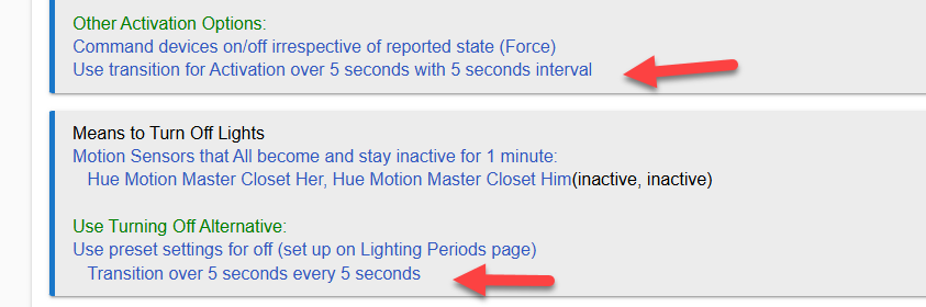

I'm working with the Room Lighting app for the first time. I want to trigger lights in two rooms when either of the motion sensors in the two rooms are activated. This would be Hue zone, the Zen77 and the dimmer plug. I want them to ramp over 3 seconds when they are activated by either of the Hue Sensor or the PIR/MMWave sensor (really the PIR/MMWave sensor is keeping the motion active). At the moment the motion is working, but I don't seem to be getting any ramp time. This is most apparent when the motion inactivity delay has been reached and the lights turn off with no ramp time.
I was really hoping this would be as simple as setting the set level for ON and another for Off for each light. Seems like I can only set the set level for the ON on each light and there is no duration.
In a perfect world I'd like to treat each light with a different ramp duration to achieve a specific effect. I have ceiling and under cabinet lighting. However, I'd like to just get this working once with some durations across them.

The 'on' part of the setup is not that confusing. You just set up the transition time and number of steps. One thing to note is that the transition is all handled in the app, not as part of any transition functionality in a light device driver.

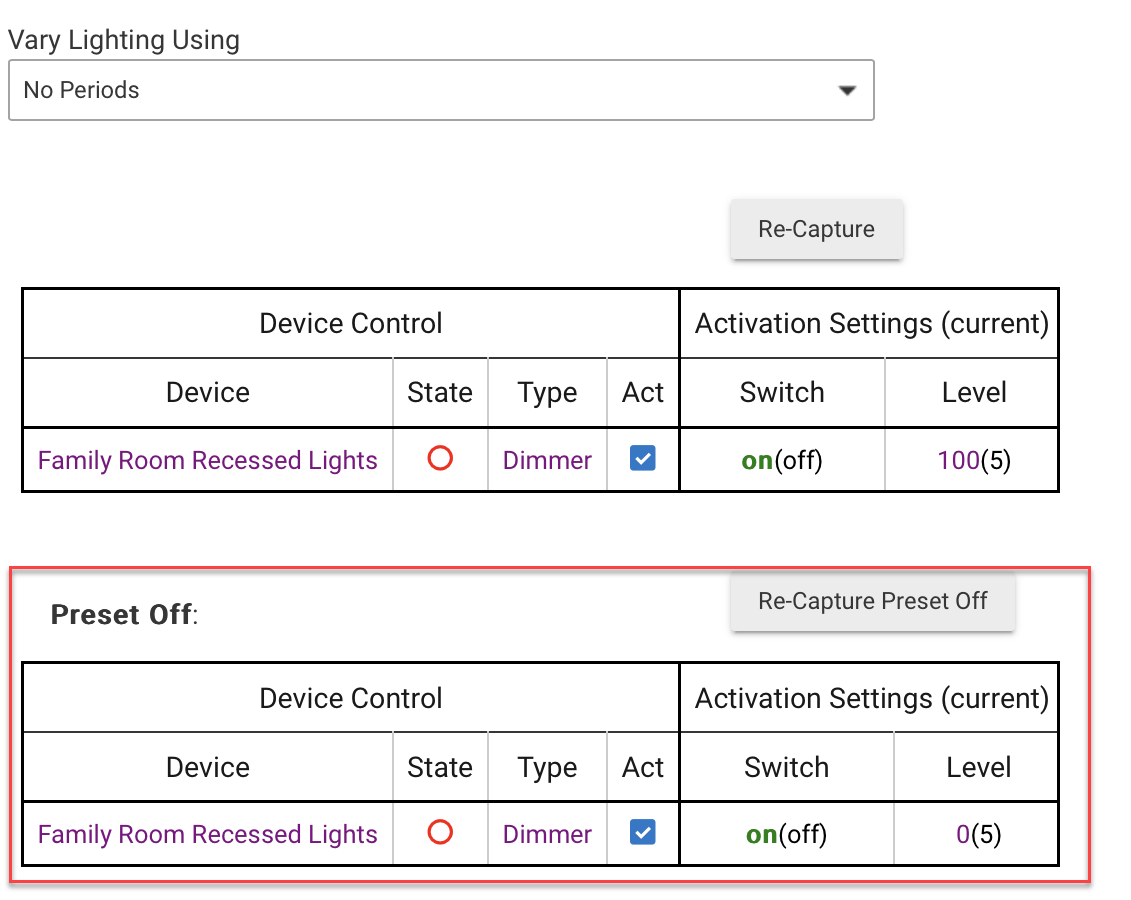

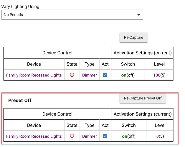

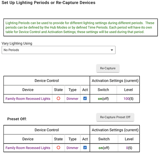

The transition to 'off' is less straightforward. In the Preset setting you want to make the target level for the dimmer to be level 0, not switch 'off'.

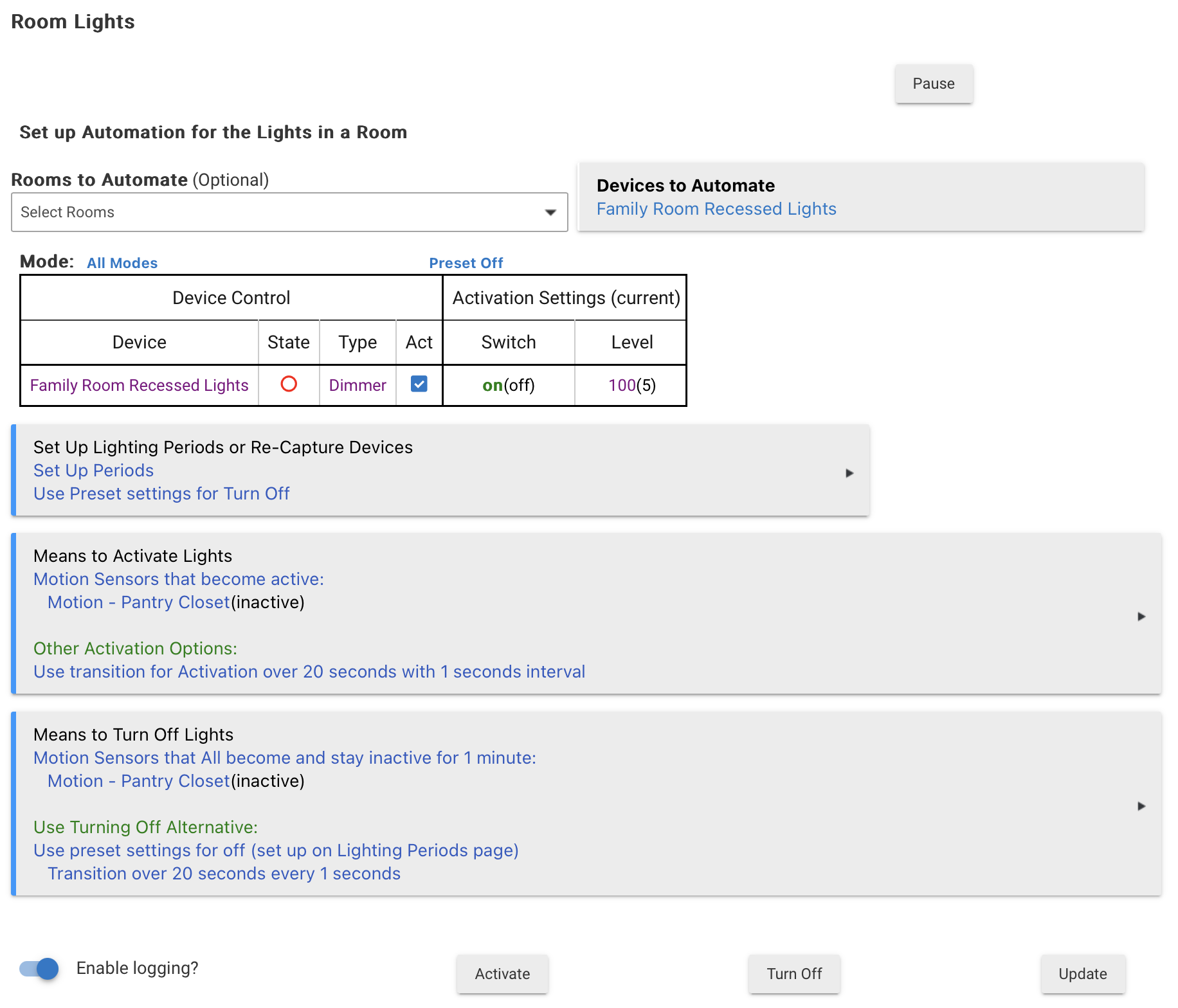

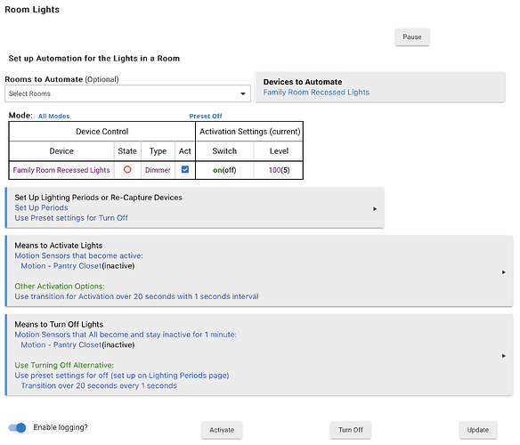

Here is the setup I just created that works as I think you are looking for. Make sure to turn logs on so you can see how the app is handling the actions.
Interestingly, I do not have this preset off box in the UI. I looked around for why that might be, but I didn't find anything. Any idea why that is not showing for me or what I need to toggle to get it to appear?
It’s under Turn Off options, Alternative Turning Off Methods.
Phew. As a software engineer that has worked on UI's starting in the early 90's...I'd say this app has many opportunities for improvement.

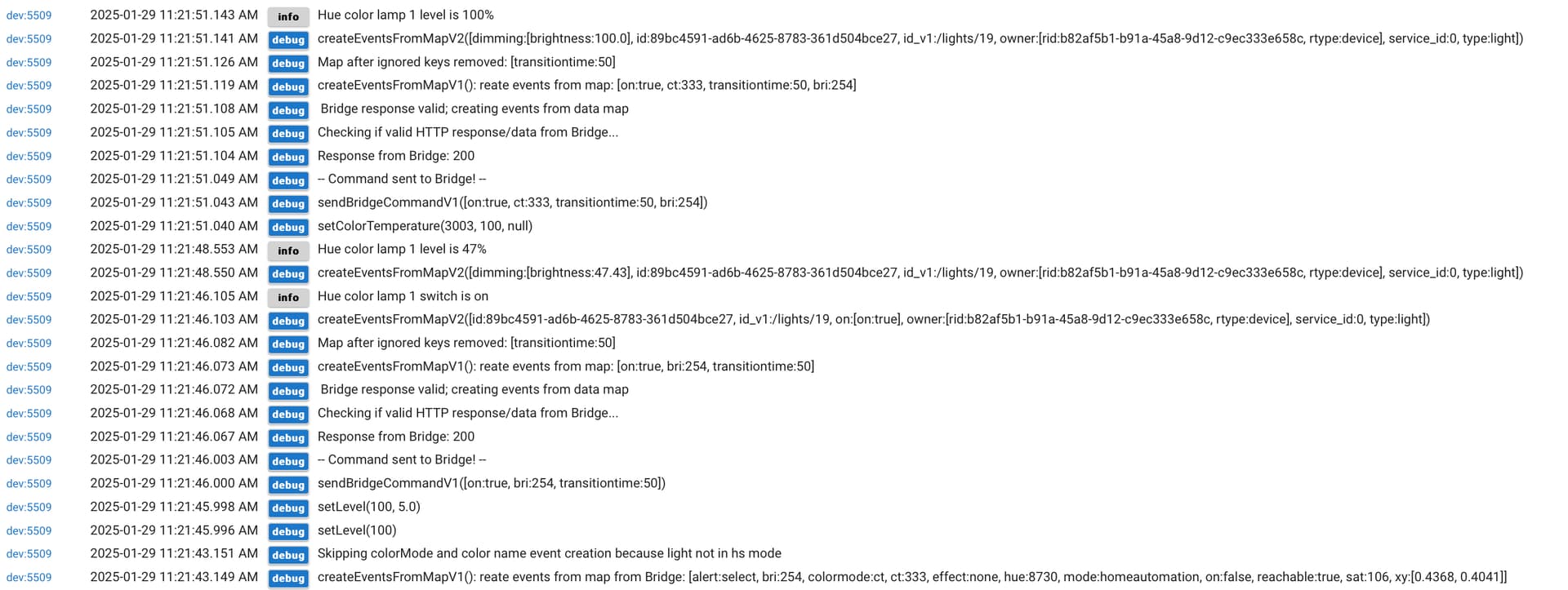

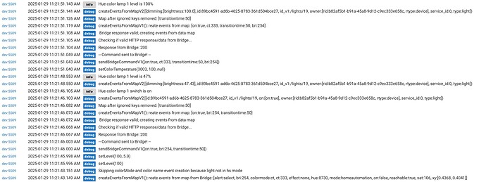

I'm able to get the preset off now, but it's still not performing. Logs are showing the setLevel events have the duration value as null even though I have the presets with 5 seconds.
Those errors are device errors. I tested on Lutron, Z-Wave, and CoCoHue Hue bulbs without errors. The newest built in Hue integration should fairly mimic CoCoHue, but perhaps there are some lingering issues.
I note that you've got a transition that I think is not likely what you are looking for. The first parameter is for the total transition time, the second is for the step length. So a 5 second step in 5 seconds is essentially a single step to off.

In the above scenario I don't have errors. Those are just debug showing the setLevel isn't sending a duration. For clarification for this testing I am not including Hue lights. Only Hue motion and those are direct with Hubitat and not through the Hue hub.
Yes, the 5 and 5 was intentional per some advice in another thread from Hubitat staff. But I still do not see a transition called with setLevel like I would expect. It was arbitrary to get it working.
