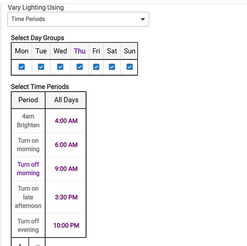

Note, I do it slightly differently that described above. I just leave this Room Lighting as Activate all the time and disable it when I flip a virtual switched titled "Christmas Season". This virtual switch controls other Room Lighting and Rule Machine rules as well.
Time periods:
Sample On and Off Time Periods
Hopefully, this helps!
