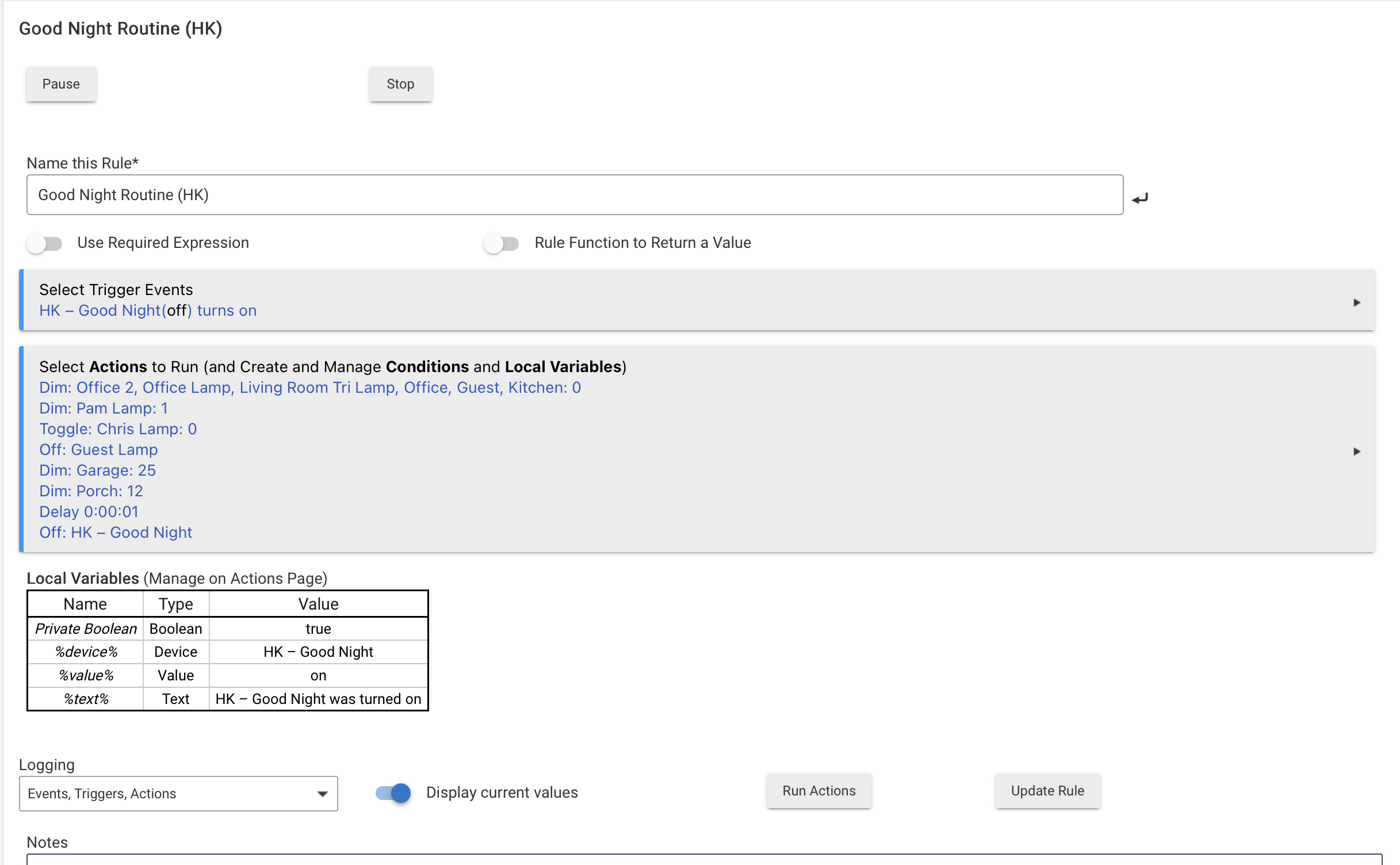

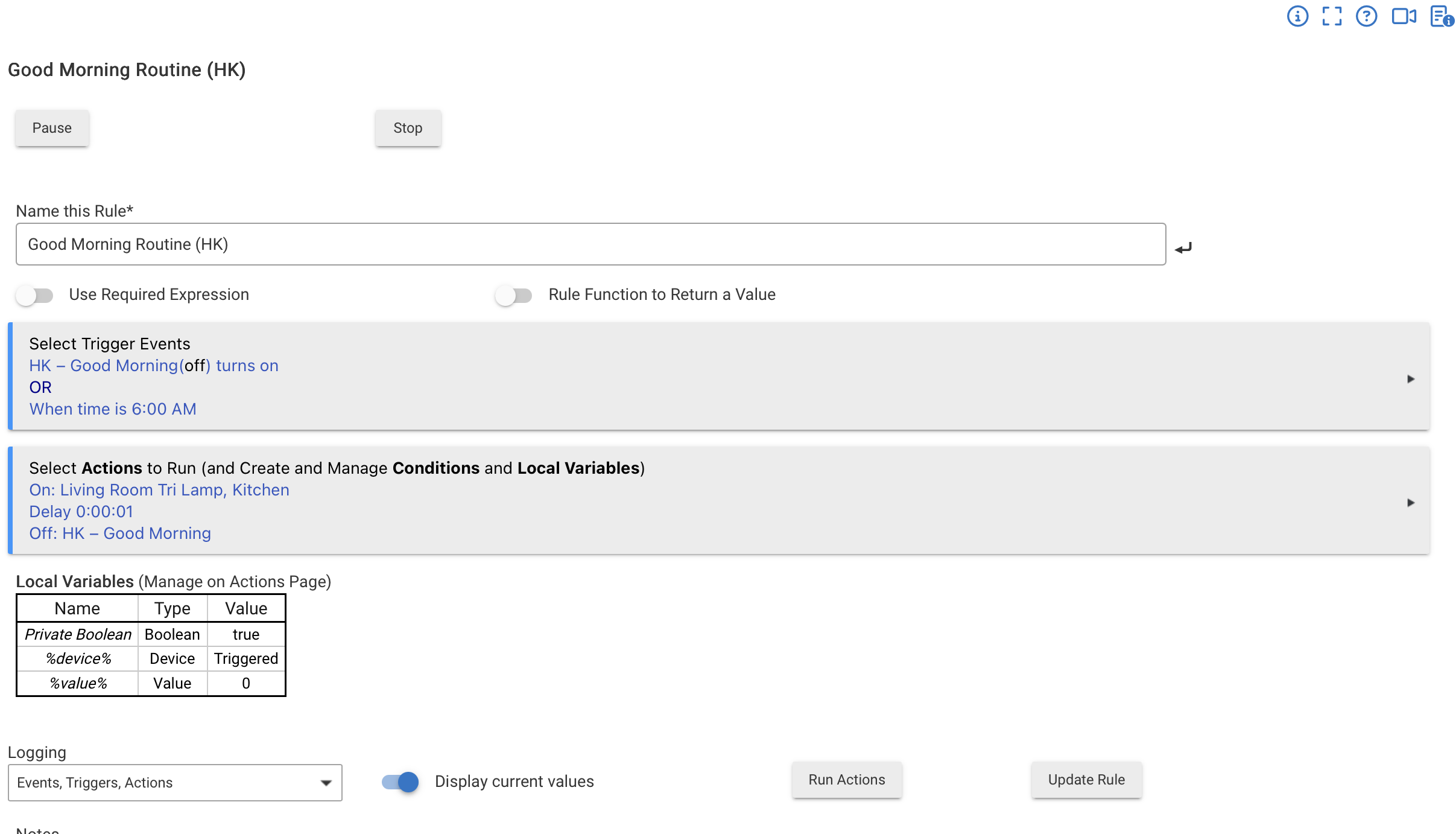

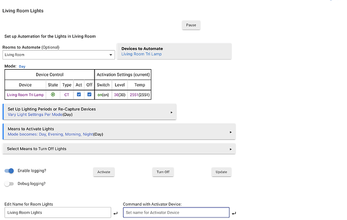

I have a second property that I am trying to get simple automation going for when we are there, and also when we are not there. When we're there, looking to have certain lights turn on at a certain time of the day at a specific color and dim level, but then change to other light settings as the day goes on. I currently have a a virtual switch in place with a Rule Machine config to turn the lights on in the morning, and then Room Lighting configs to change light settings at various Mode Manager settings throughout the day. Another virtual switch is in place to turn the lights off at bedtime via HomeKit voice command, or a specific time - whichever comes first.

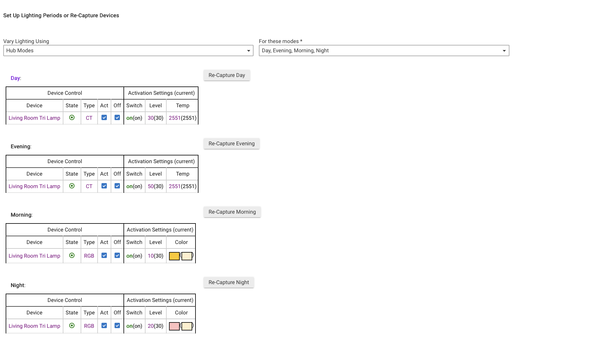

I'm struggling to have the lights change to the correct dimming and colors during the day via the Room Lighting settings (I have one in place for each room) and the Mode Manager setup. Some lights dim and then the colors usually never change as programmed correctly.

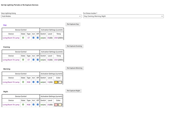

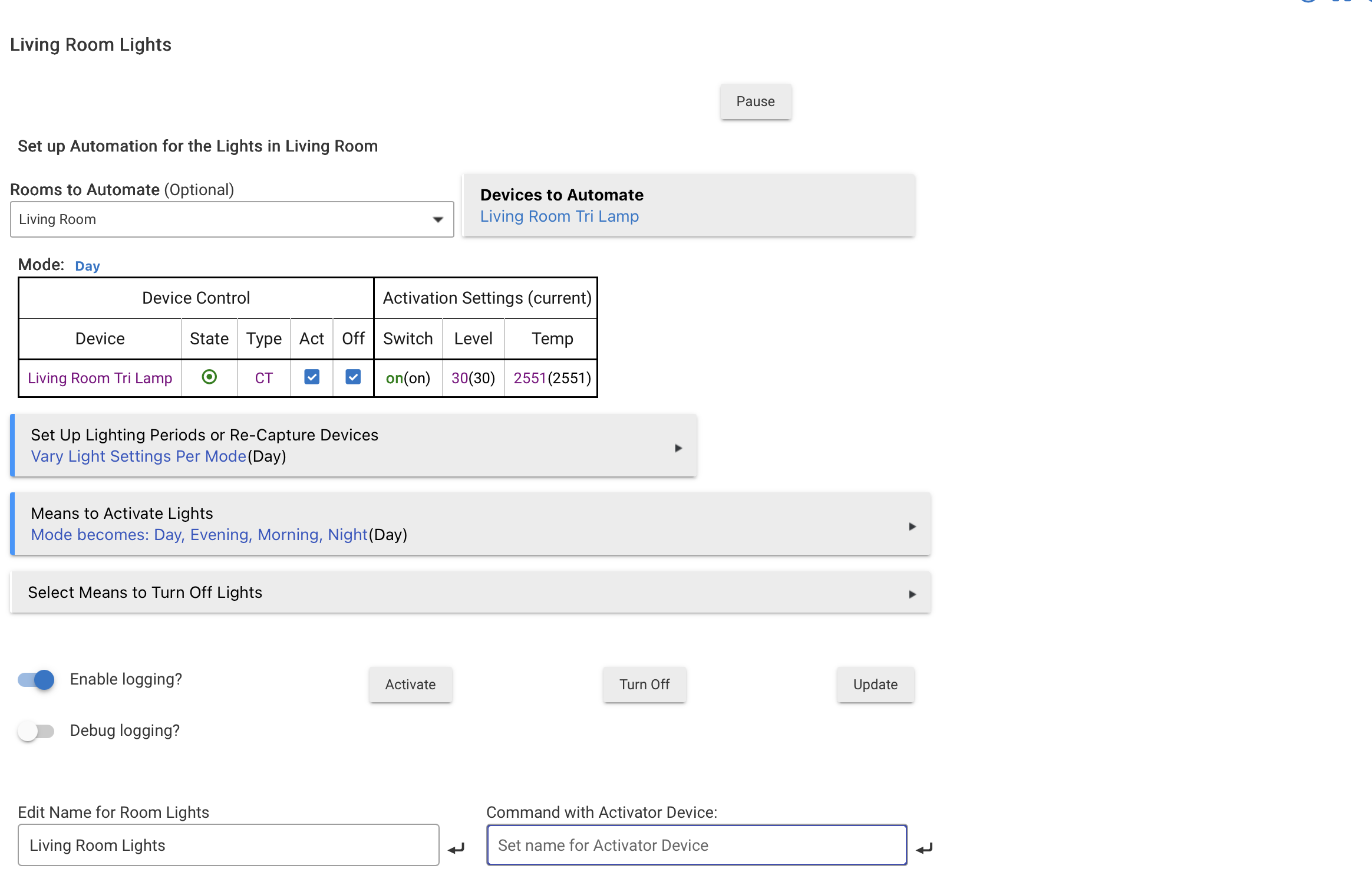

Below is a screenshot of one of my Room Lighting for just one of the rooms, as well as the Rule Machine rule to start everything off each day.

This is an easy fix. In Room Lighting select Means to Activate, then select activate light options, and finally select the drop down box labeled Additional Options. One of these options should be adjust lights on mode changes. This will automatically adjust the lights as your modes change.
As for everything else, this could probably all be handled with Room Lighting and a virtual switch. You probably do not need Rule Machine

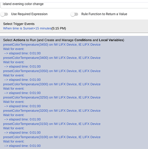

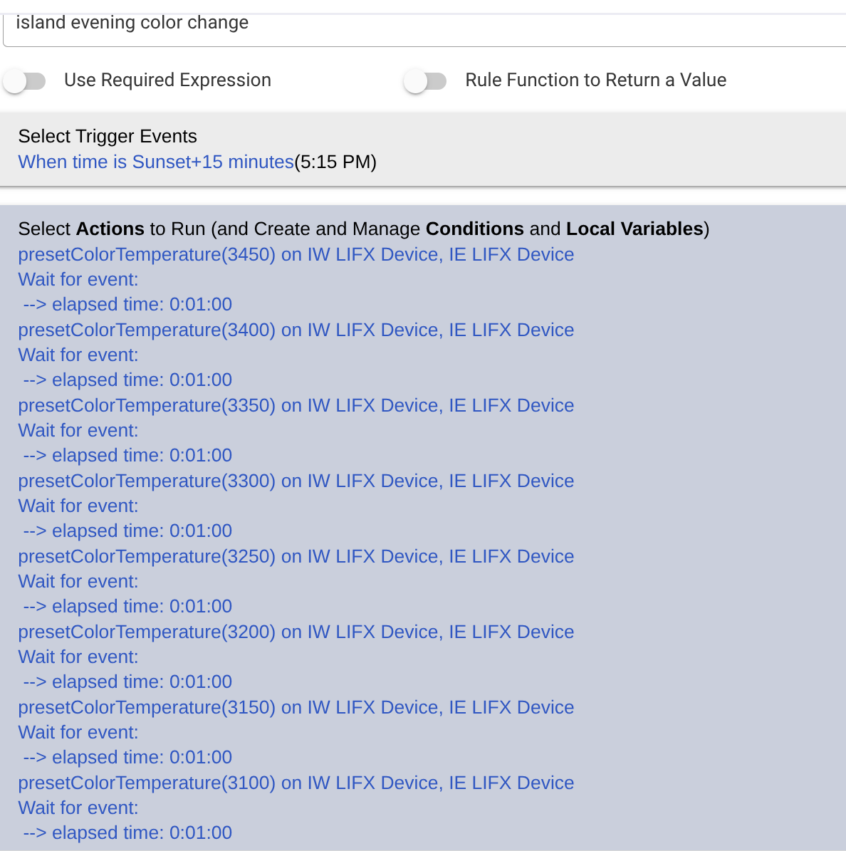

I walk down color temperature in the evening with rule machine with "preset color temperature." It is in imperceptible steps. The reverse in the morning. I believe you can do the same with preset level. Depending on the Smart bulb, they do not have to be turned on to accept the setting.

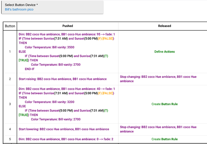

A different approach with button controller with Picos for controlling the vanity lights color temps.
