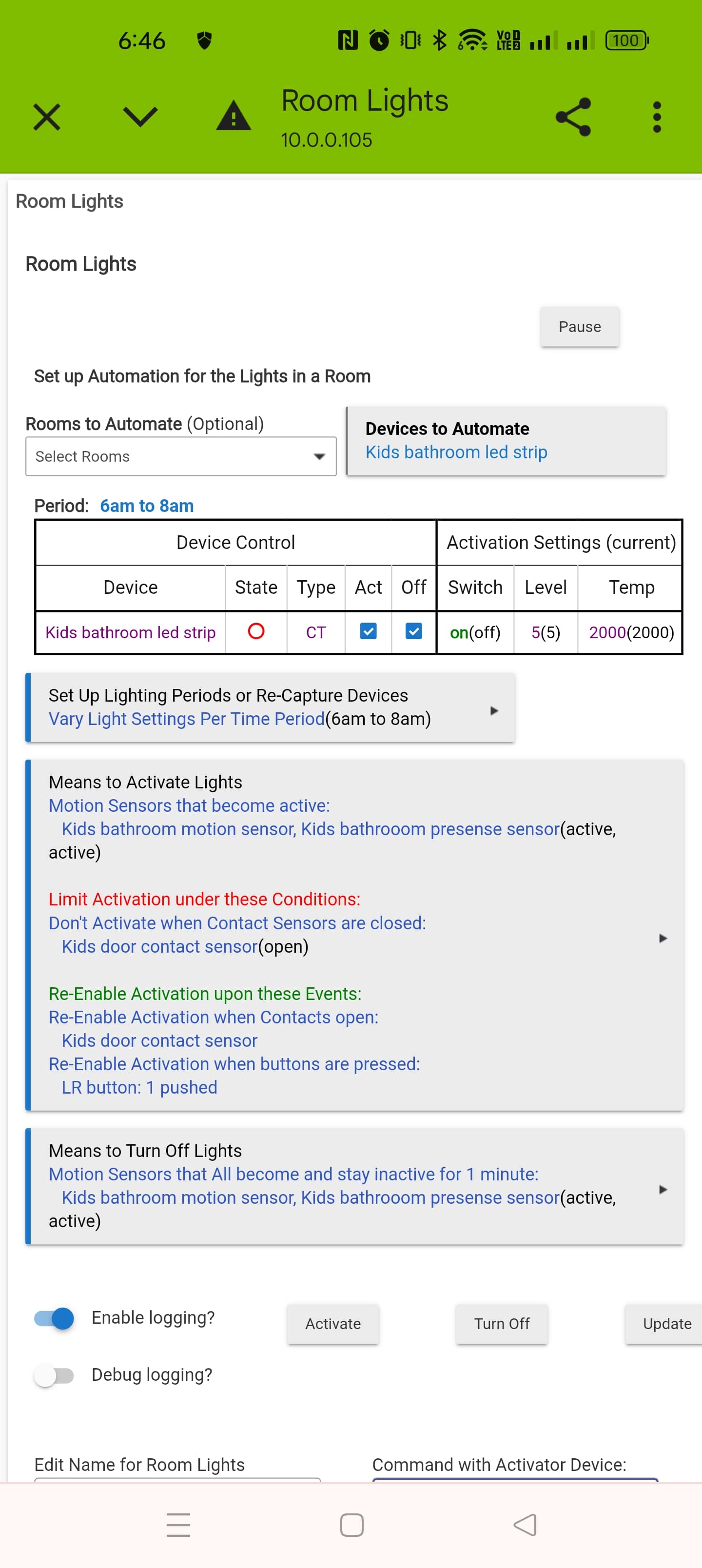

Is this about right?

What you have activates on motion, contact and buttons. I thought you wanted only contact and buttons with motion as a Condition??

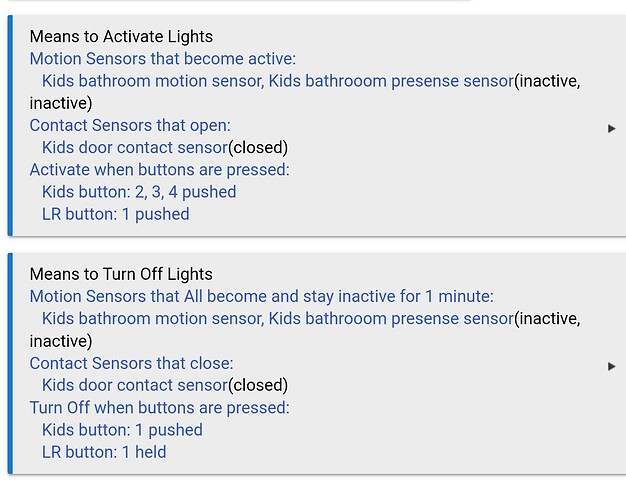

I read the documentation again and set the RL diffrently. Does the following make sense?

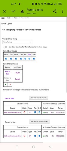

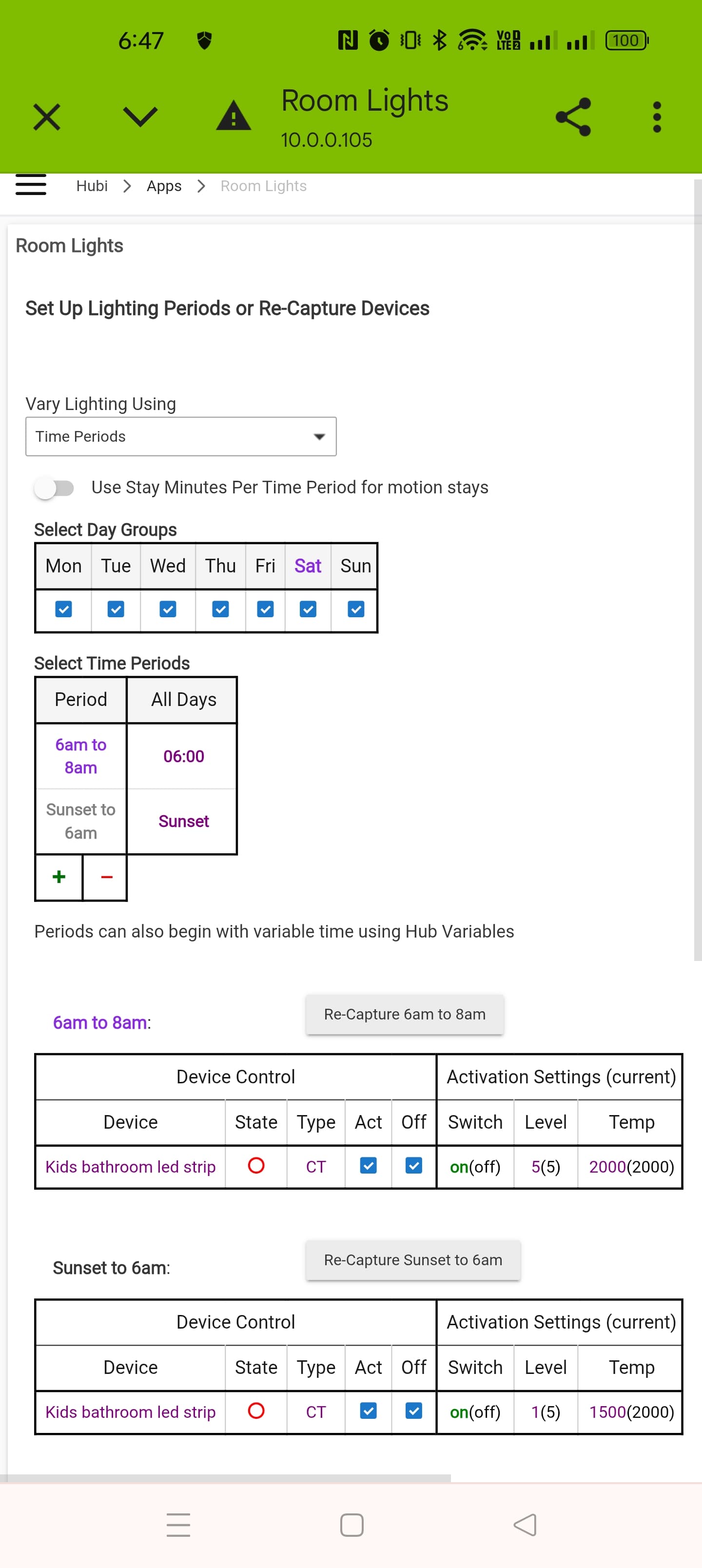

I also read about time periods and i decided that from sunset to 6am the light will be weaker, and from 6am to 8am the light will be stronger so is set the following.

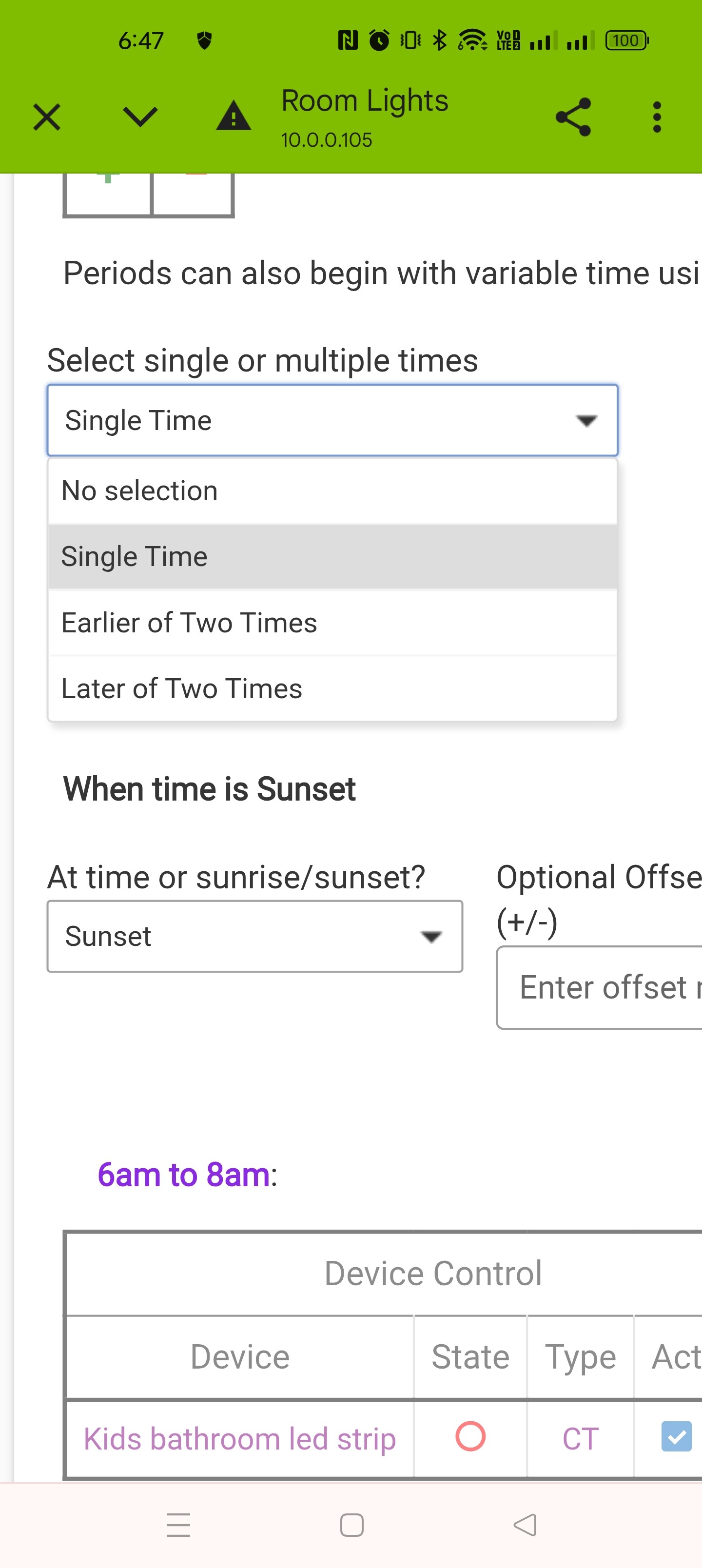

I didn't quite understand the "earlier of two times" or "later of two times".

It seems off to me that you're still using motion active as the primary means to activate when it's really not... Why not use contact-open and button-push as the means to activate and then limit activation to only when motion is active?
Earlier/Later of Two Times is most commonly used with sunrise/sunset stuff -- there may be lighting things you want to happen by a certain time, but that need may vary over the year dependent on how much (or little) daylight is available at that certain time.

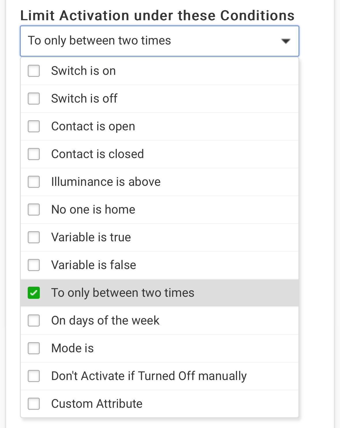

I can't find in "limit activation under these conditions" motion sesnor, that's my main problem.

You have to use Custom Attribute, and select motion there.
