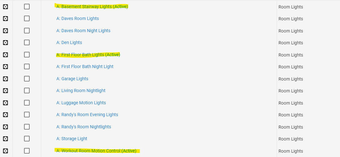

I created a dashboard of switches with my activators on it (so I can see which ones are running at any point in time), and they are always listed as "off". Example:
All the switches are "off" even though three of the automations are "active". I haven't tried a conditional check in a RM to see if it is REALLY off or not, but I kinda would have thought the dashboard would reflect the current state of whether it's active or not...
There is options in RL to make the activator work like a classic "group" and you can have it trigger to on for Some On or All On. If that is not enabled the activator may not change states, I have never set one up without one of the group or scene settings enabled.
That was it. It was selecting either of these:
I just never thought to select them as my "group" is actually only 1 device (a wall switch).
