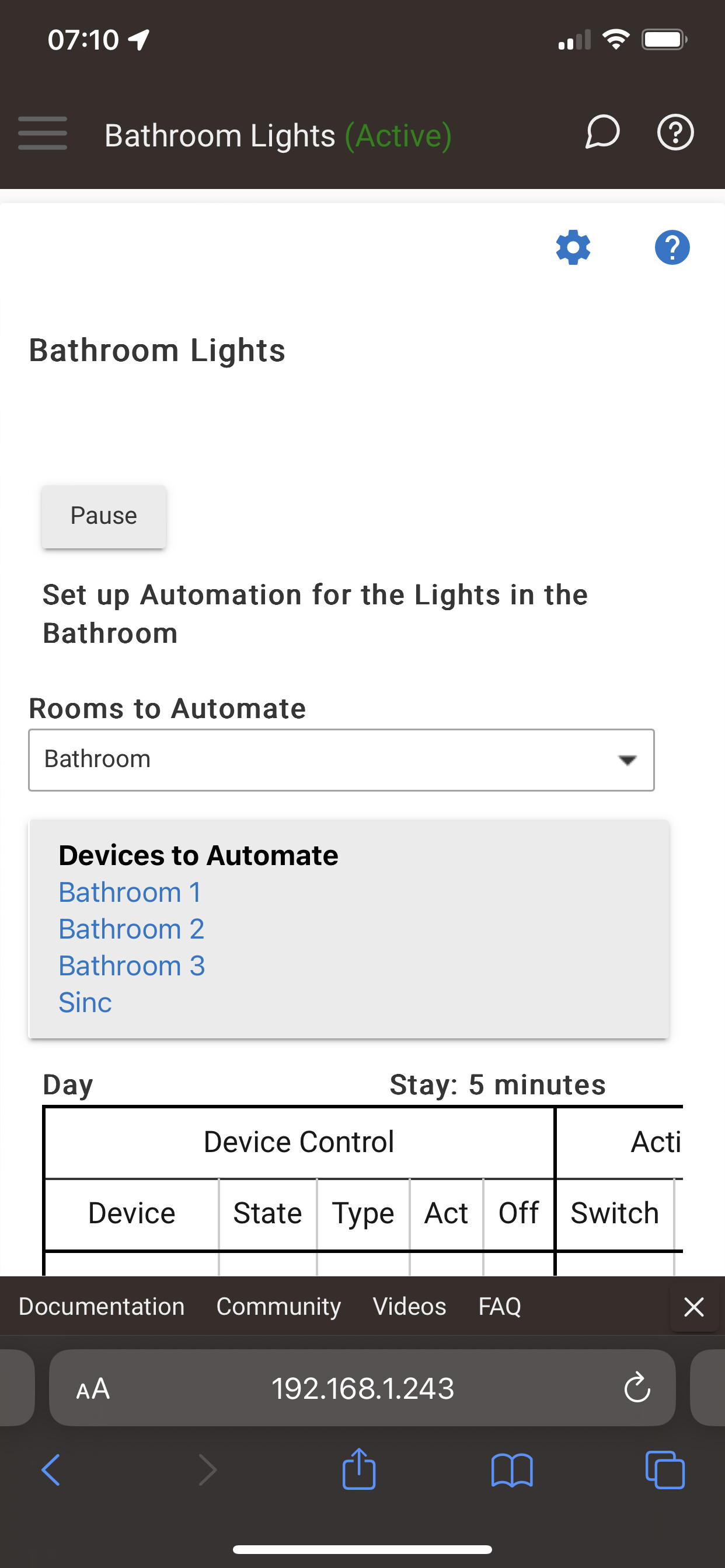

I updated my hub and this new room lighting app is amazing except for one point.
When I enter my bathroom I have 2 motion detector devices that would trigger an automation to turn on the lights.
But if for any reason I turn off the lights manually (homeKit or Philips hue) I will have to wait 5 or 10min for Hubitat to turn on the lights via the motion devices.
The image attached is my automation, fairly simple:
Turn On if movement detected
If no more movement turn off
This happens with my hue lights and room lighting automations as well. I got around it with aurora dimmers directly connected to the hue hub. Never actually figured it out though. I’d love to hear how to fix this
