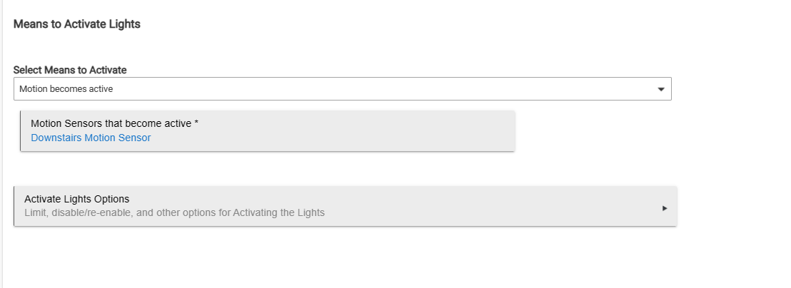

Here's the rule I have set up.

Interesting...I might be missing something, but I don't see anything that should cause that problem. You might want to try re-creating this automation just to see if that helps (shouldn't matter, but maybe if it was configured differently in the past and something unintended got "stuck"?). Otherwise, maybe one for Bruce to look at.
I recreated the RL rule from scratch, and it's working as expected.
Something must have gotten messed up when I created it originally.
