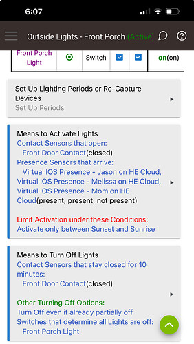

I have a few outside lights I noticed stopped running lately that have always been solid performers. The lights turn in based on the trigger ok, but they’re not running the turn off routine.
Did Melissa use the Front Door in that particular arrival instance?
If so, do its logs show that its contact sensor opened and closed as expected?
Interesting thought now that I think of it. The garage door was open so she actually went into the house through the inside garage door instead of the front door, thus bypassing the front door and never opening / closing the front door. We just started using our garage more since we bought a new car. So I will have to add the inside garage door to this rule and see if it helps.
