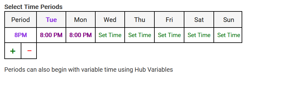

The way you have it set up, ALL days would be the same time periods (as indicated by the single row with M, T, W, Th, F, Sa, Su checked)
When you have the day groups set up, you need to keep unchecking each day until it gets onto it's own row.
Once you do that, it should look like this
Multiple Day Groups
Then you create a new time period and name it what you want. I used "8PM"
Then you set the time for each day by clicking the set time (Not sure this is needed if you are just going to activate it at 8)
Create Time periods and set time
After that, you will have different configurable settings for each time period and day you have set up. Just click the number under level, temp, or in your case color to change them
Multiple Settings
