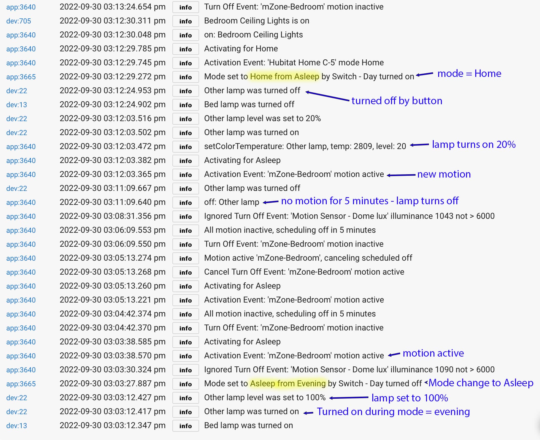

I ran a test to mimic my normal go-to-bed routine. And the Other Lamp did not dim to 20% when the mode changed.

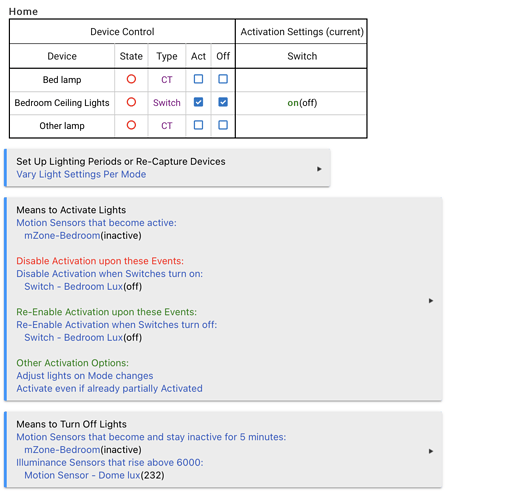

This is what the RL app looked like after the mode changed to Asleep:
Here is the device page:
This is the RL app after 5 minutes of inactivity have passed, the light was turned off, and then motion turned it back on at 20%:
And here is the log:
Your logs you posted are confusing with too much going on for me to tell what is happening. Where is the mode change that should have adjusted the Other Lamp but did not?
hope this is better or easier to understand
