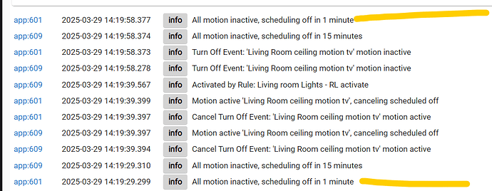

the "normal" on is still turning the lights off
It clearly says ignored but it still puts the off timer in ? why ?
nope still happening

@johnwill1 this is still happening
the 1 minute is the living room rule below
@johnwill1 I think i found it - I have the force on - why ? becuase i have lots of issues with this now turning on or turning off so having the Force was a way for things to have a second chance to get the commands
