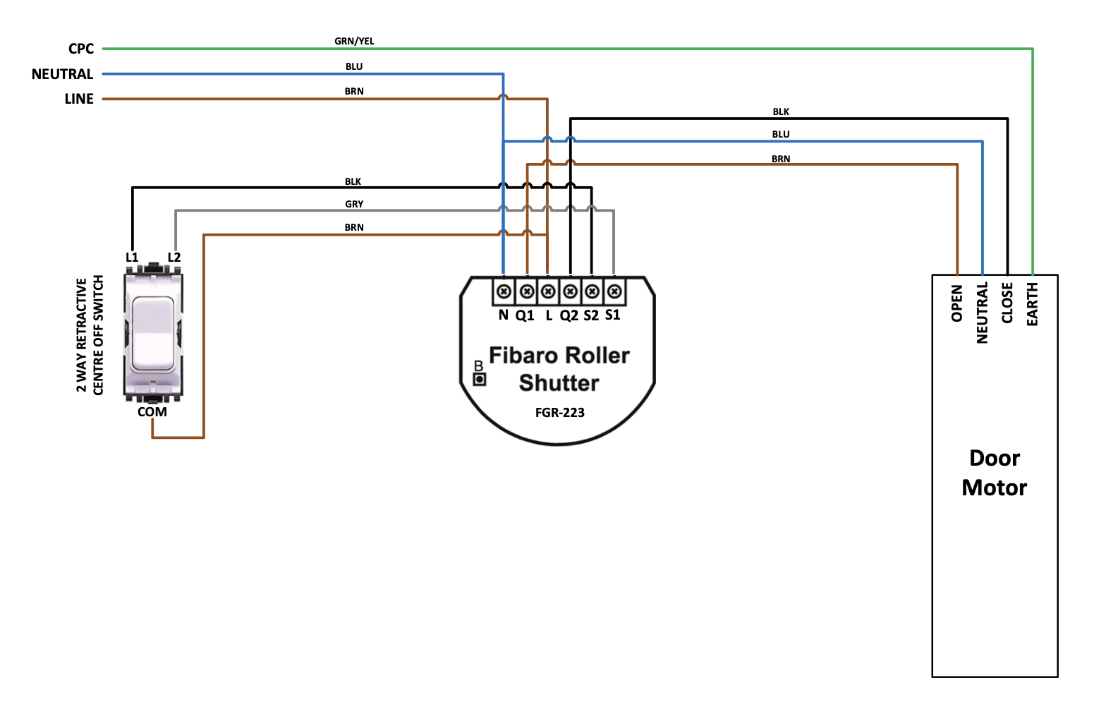

@jb1 - For 3 wire 230V shutter motors (open, close, neutral) I've use both the Fibaro Shutter 3 and the Qubino Flush Shutter in my system.
Fibaro shutter 3 - I've used that for my garage door. As it's a roller shutter I basically pulled out the existing controls and connected the 230V tubular motor to the Fibaro module to which I've also got a two way retractive, centre off switch for local control. No issues at all. I did have some problems using the Fibaro Shutter 3 with my curtain motors which are also 230V 3 wire (Dooya DT50S). On those the Fibaro struggled to sense the load and stops on the motor so I used....:
Qubino Flush Shutter - that works great. Similar scenario to the garage door; I have the 230V motors wired direct to the Qubino module and have a 2 way retractive centre off switch adjacent each curtain for local control. I did myself a Visio drawing at the time (when I intended to draw out and document everything I've done Smart home wise....never happened lol)
