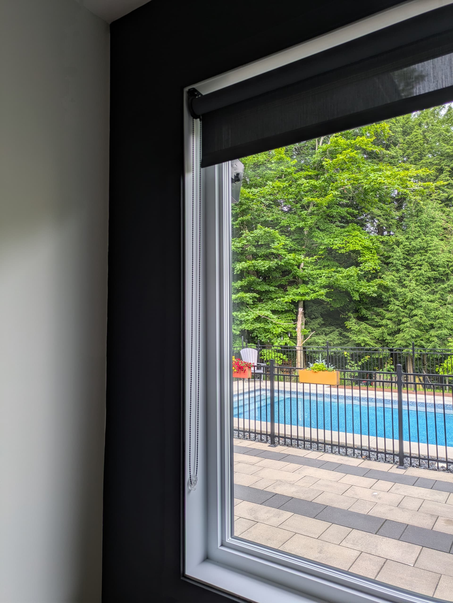

These are roller blinds with plastic chains. My favorite thing would be to add a motor directly into the tube. I added a picture. All the blinds in the house are the same.
AM43 motor. I use one in my kitchen. Flawless. Zigbee.
Thanks for the suggestion. What would be your suggestion for a Zigbee motor directly inserted into the blind tube instead of a motor attached to the frame that uses the chain?

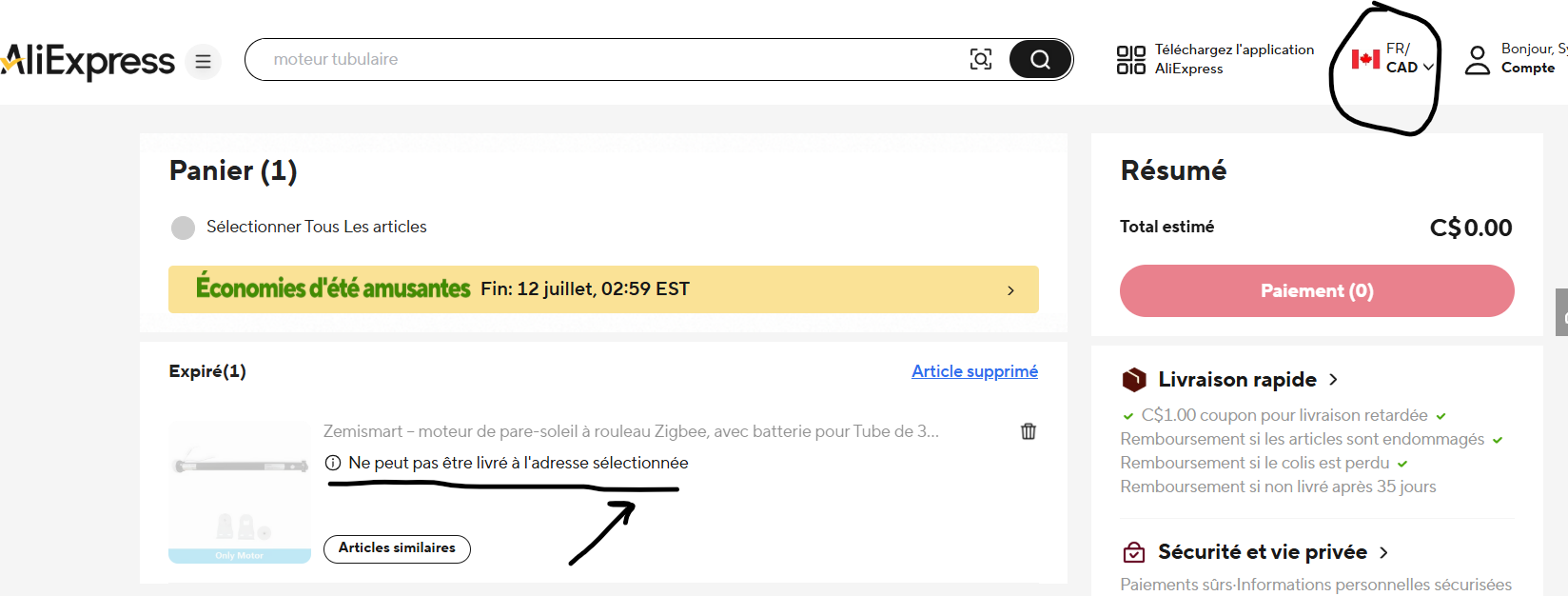

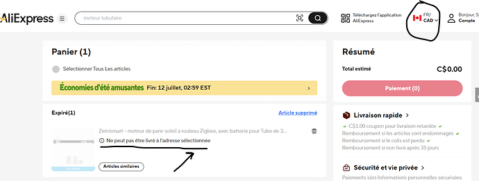

Hello; here is the note when I add the item to the cart (in French): cannot be delivered to the selected address. At the top of the page, we see that it is the correct country and if I go to the account settings, it is indeed my postal address that is listed.
Hello. Finally, I managed to order! There was a link that said 'similar item' and it worked. To be continued for pairing with Hubitat. Thank you again. I will post the rest of the installation after delivery. Have a nice day!
