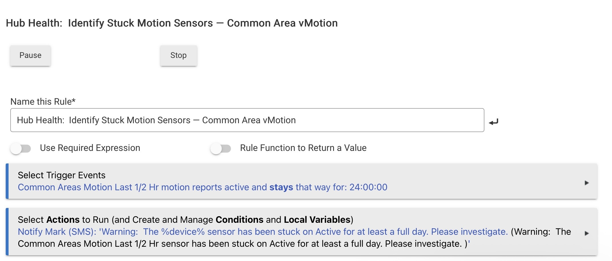

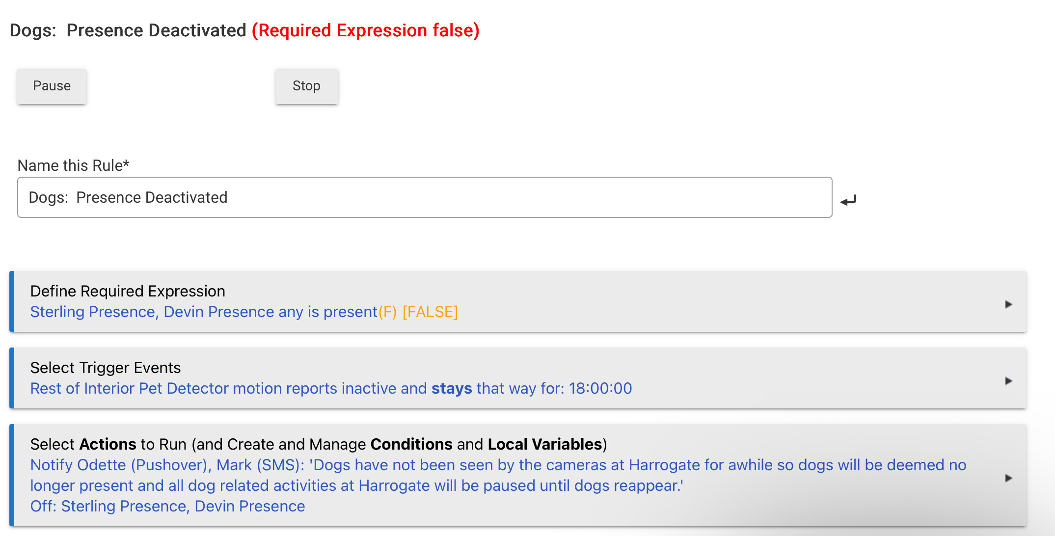

I didn’t because there are a dozen of them. They all follow the same structure. I’ll post a couple examples. Below are the 2 examples described in OP:

Rule and Log Detail
Log:
2025-06-10 12:54:39.325 PM error java.lang.IllegalStateException: app 1492 has 76 scheduled jobs already on line 9767 (method allHandler)
Rule:

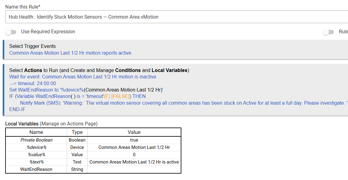

Here is an alternative:
Trigger Event:
Motion *changed*
Actions to Run:
Wait for event: elapsed time --> timeout 24:00:00
Notify: "%device% %value% for 24 hours!"
Sometimes people question if this approach will actually work, and the answer is yes; if it's confusing, the Rule 5.1 docs explain the cancellation behavior that make this work -- a trigger event cancels the "Wait," so you'll only get to that notification if it stays in that state for 24 hours (or whatever you say).
This is a bit easier if you care about getting "stuck" in either state; if you only care about one, you can trigger on active, use "Wait for event: motion inactive --> timeout 24:00:00" instead, then set a local variable to %device%, see if that variable equals "timeout" (this is what will happen if this action was reached due to the timeout, as opposed to the triggering device name -- so you'd also need to modify your notification a bit from my example), and enclose the notification action inside this conditional so it only runs in that particular case.

This is a perfect answer, thank you! I'll write out the one-sided event version and post here later for those that follow.

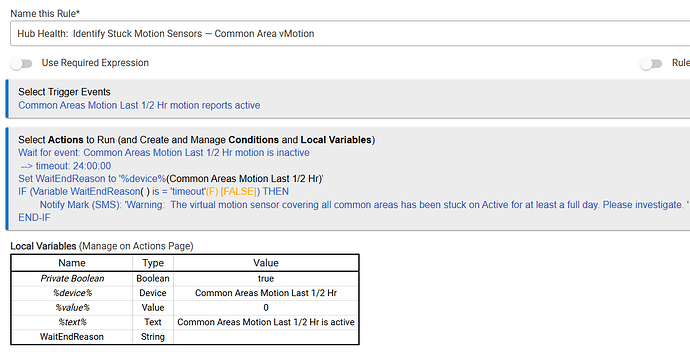

EDIT: Here's a rule instance for just one side of a sticky event....thanks to @bertabcd1234!
