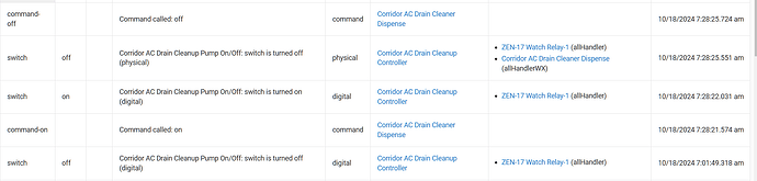

However the Device Event page clearly logged a device activity around 1:30am:
And here is a log from previous day run around 1:30am
According to this log pump was running twice:
First run for 5 sec:
and second run for 4 sec after 13 sec delay:
