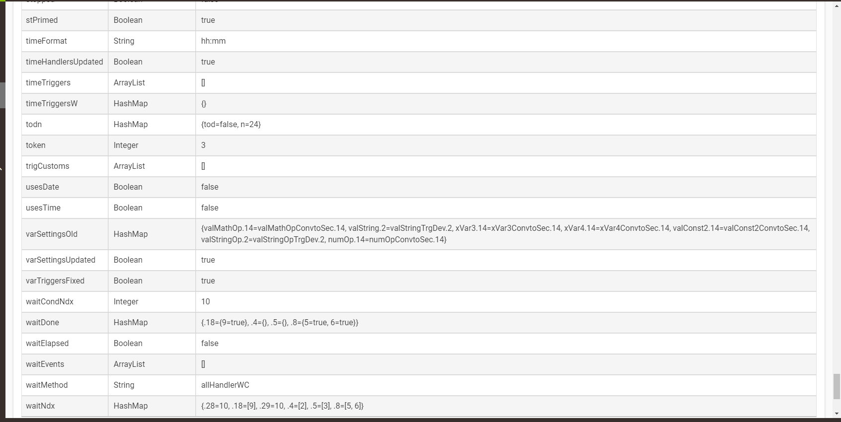

I think this is what you're asking, is this enough of bottom portion?
It appears to me as though the Wait for Expression action has been corrupted somehow. Please delete that one action, and recreate it. Then post the same thing as the very last screenshot above.

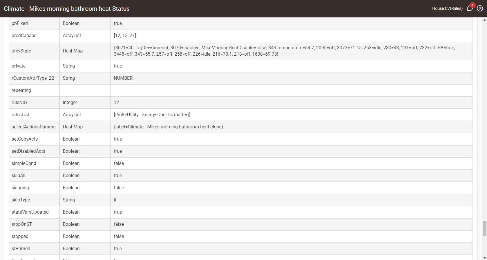

Please post a similar screenshot, but for the very first part of Application State, where the a's are listed.
Try it, I think it might work.

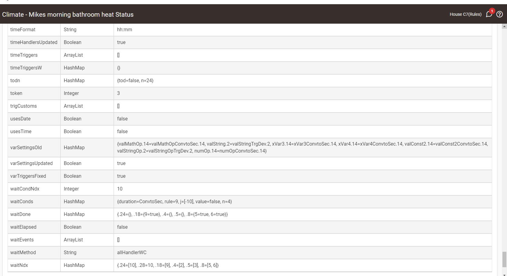

It's set to run again in the morning, If I get a chance tonight I will set it up to run tonight.
It did run this morning. I tried it last night but realized when I added the line back I set it as a duration instead of a timeout, and I didn't have time to try it again, so I just edited and decided to wait and see if it worked this morning. So apparently the editor corrupted the rule for whatever reason.
