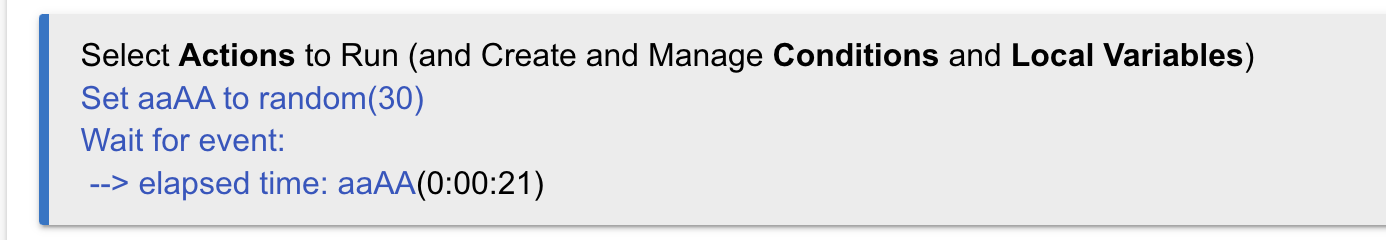

Why don't you just use a variable (number of seconds) and put a random number in it before the Wait?
Like this:
Makes sense Bruce, appreciate your swift response :+1:
