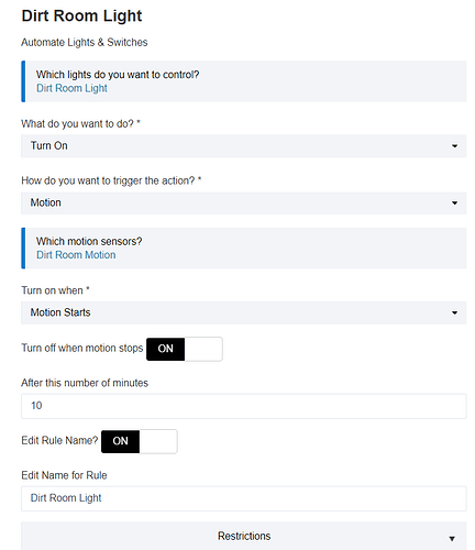

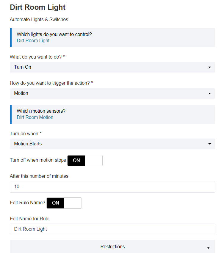

I took a slightly different approach, used the built in Hubitat Simple Lighting. You will need to add the time restriction
Should work for you
