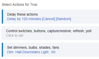

With RM it's possible to delay things for a random time.
i.e. Delay by 120 minutes and select Random. The delay is a random time between 0 and 120 minutes.
Could it be possible to have Delay by 60 to 120 minutes - Random. The delay is a random time between 60 and 120 minutes.
