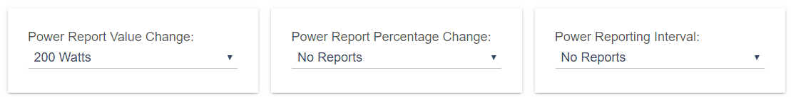

Have you tried adjusting the power reporting preferences for the plug? Maybe, something like this would limit how often it triggers but would trigger immediately if the TV turns on or off.
This my current config on this device.
That's weird. With those settings, I wouldn't think the 0-1.5 watt changes would be reported.
Was my thought as well...
