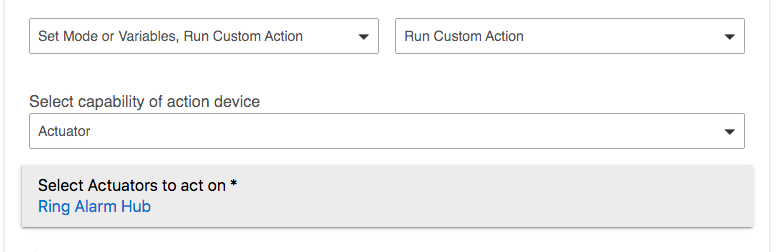

Sorry for resurrecting an old thread...How did you create the 'setMode on Ring Alarm Hub? did you have to create a variable (still learning)
Thanks.
Here is where you will find that setting.
Thank you!
