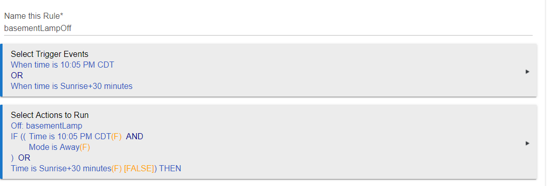

Having trouble with a rule. I'd like turn a lamp off at 10:05 if I'm away, otherwise turn it off after sunrise. We leave it on at night for one of the kiddos. It seems to always turn off at 10:05.
app:1332019-08-19 03:13:55.094 pm infobasementLampOff: Resumed
app:1332019-08-19 03:13:52.651 pm infobasementLampOff: Paused
app:1332019-08-19 06:50:00.960 am infoAction: IF (( Time is 10:05 PM CDT(F) AND Mode is Away(F) ) OR Time is Sunrise+30 minutes(T) [TRUE]) THEN
app:1332019-08-19 06:50:00.647 am infoAction: Off: basementLamp
app:1332019-08-19 06:50:00.578 am infobasementLampOff Triggered
app:1332019-08-19 06:50:00.542 am infobasementLampOff: Triggered at Certain Time
app:1332019-08-18 10:05:00.631 pm infoAction: IF (( Time is 10:05 PM CDT(T) AND Mode is Away(F) ) OR Time is Sunrise+30 minutes(F) [FALSE]) THEN (skipping)
app:1332019-08-18 10:05:00.409 pm infoAction: Off: basementLamp
app:1332019-08-18 10:05:00.352 pm infobasementLampOff Triggered
app:1332019-08-18 10:05:00.322 pm infobasementLampOff: Triggered at Certain Time
That's correct or at sunrise +30mins. Because that's what you have told to do. You condition does nothing because it's after the off.
You have put the action to turn the light off at the begining.
At 10:05 it will turn the light off.
Thae action to turn the light off should be after the conditions.
