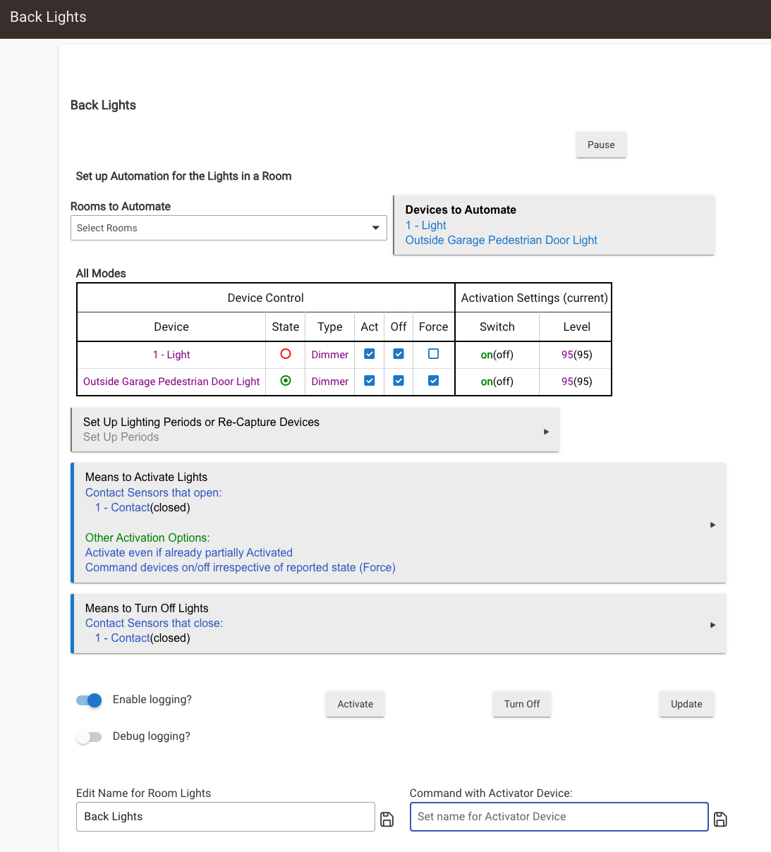

This is driving me crazy! 1 - Contact is a virtual switch. 1 - Light is a virtual dimmer. Outside Garage Pedestrian Door Light is a Generic Zigbee Dimmer.
Expectation is when 1 - Contact is opened both the virtual and physical lights would turn on, right?
But the behavior is the virtual dimmer turns on, then sets to 95% - expected. The physical dimmer is NOT sent the "on" command, just the setlevel 95% and that does NOT turn the switch on.
I found a workaround, I took out the physical dimmer and crated a Switch Binding between the virtual dimmer and the three physical zigbee dimmers I actually am trying to control. This works - but adds a whole new complexity that should not be needed.
Why is RL not sending the on/off command and only sending the setlevel when the target device is generic zigbee dimmer? And then why does it go "X" state as not responding?
