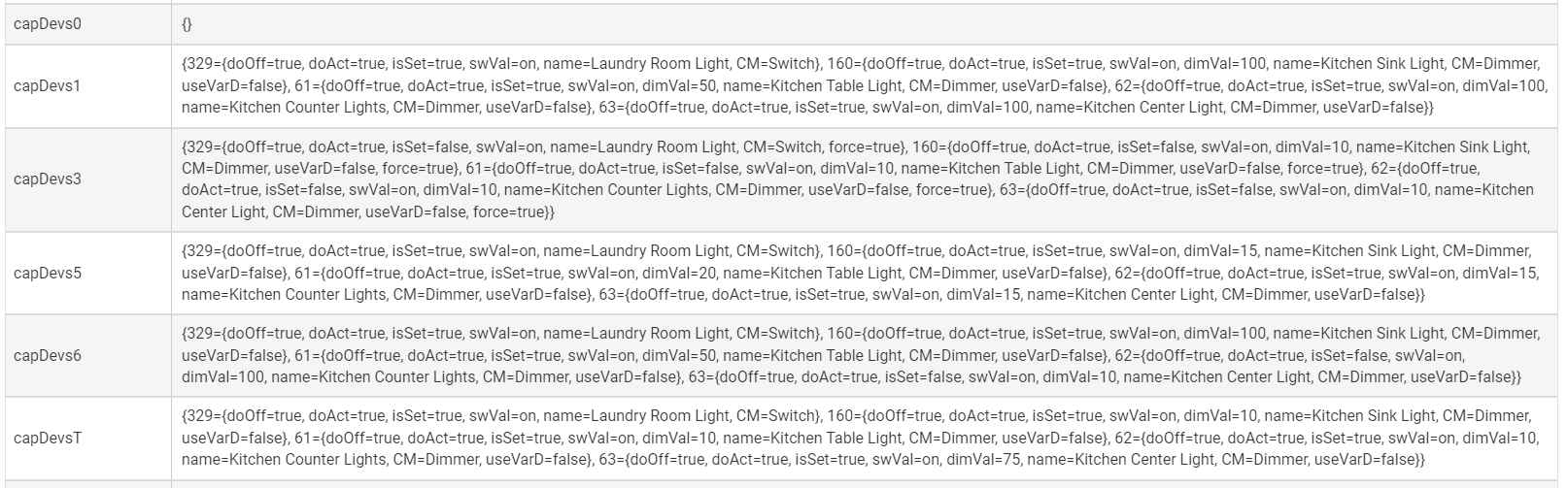

@bravenel Getting this error ONLY when I command a single device using the red/green circle in the RL app. Was also getting it on firmware .136, thought it would be best to make a new post for this.
I did turn on the "Transition" thing at one point, I assume thats what capDevsT is for. I did not do anything with it, just turned it on, looked at it, and turned it off again. After that is when I noticed the error but it could have also been from one of the firmware updates that started it as well.
Mode is "2-Day" during this test
Don't mind the red X's thats another issue I posted in another thread.
States I know you are going to ask about
