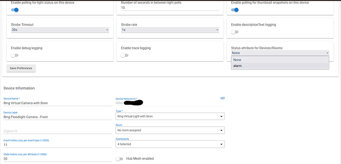

Yeah, it's weird. The on and off button work, but if I try to use it as a switch in the dashboard it won't update the switch's status. I'm guessing because the light isn't returning an on or off attribute.
Below is a snapshot of it one camera.

I figured this out, the issue was that I had to re-log into my ring account. Once I did that everything worked correctly.
I still kept the Rule to manage the lights because the Polling just takes too long to return an Off/On status.
