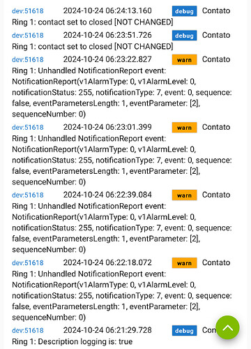

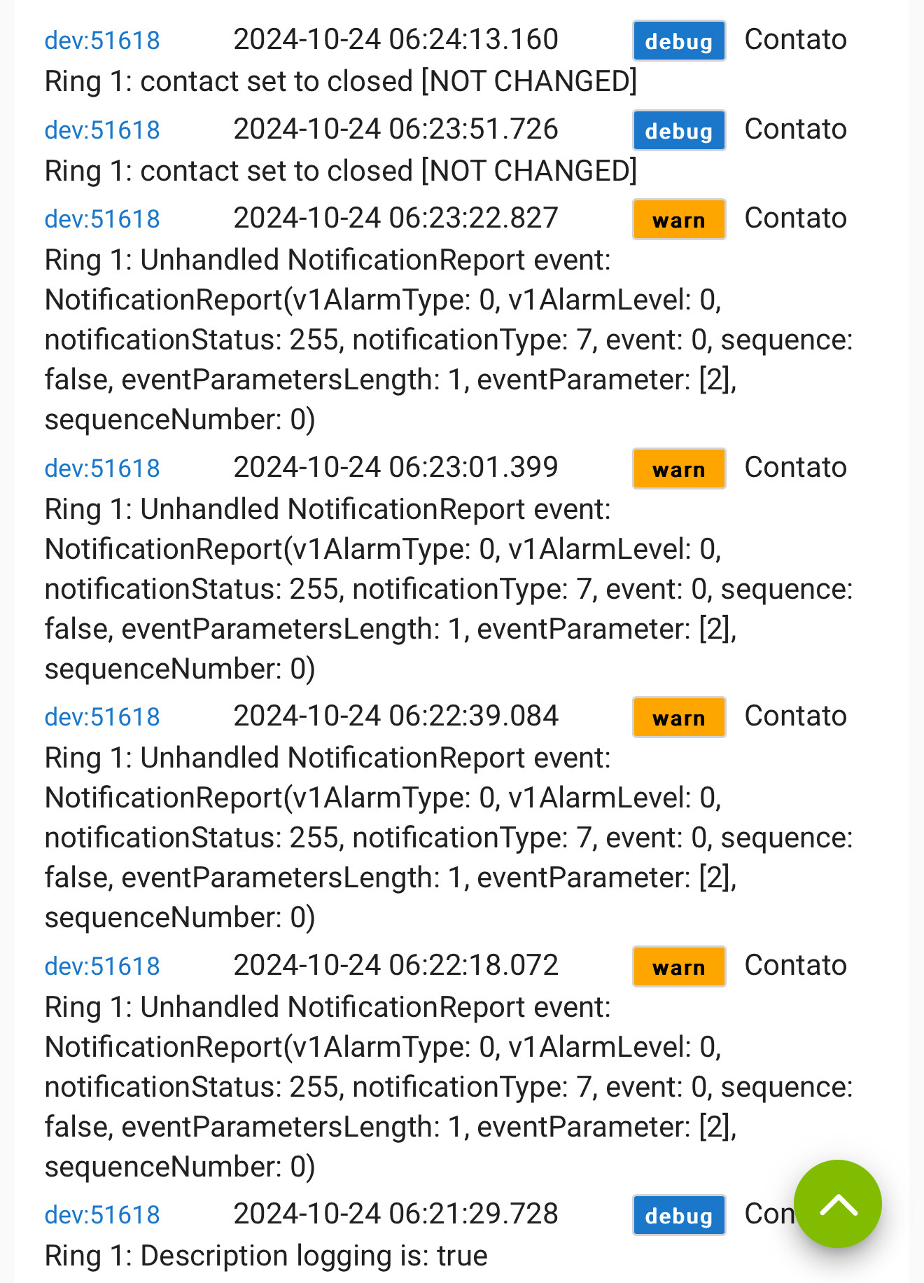

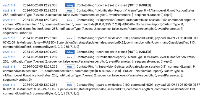

There you go. I enabled debug logging and opened and closed the sensor twice. Here is the output, and yes, the led becomes red after some seconds.

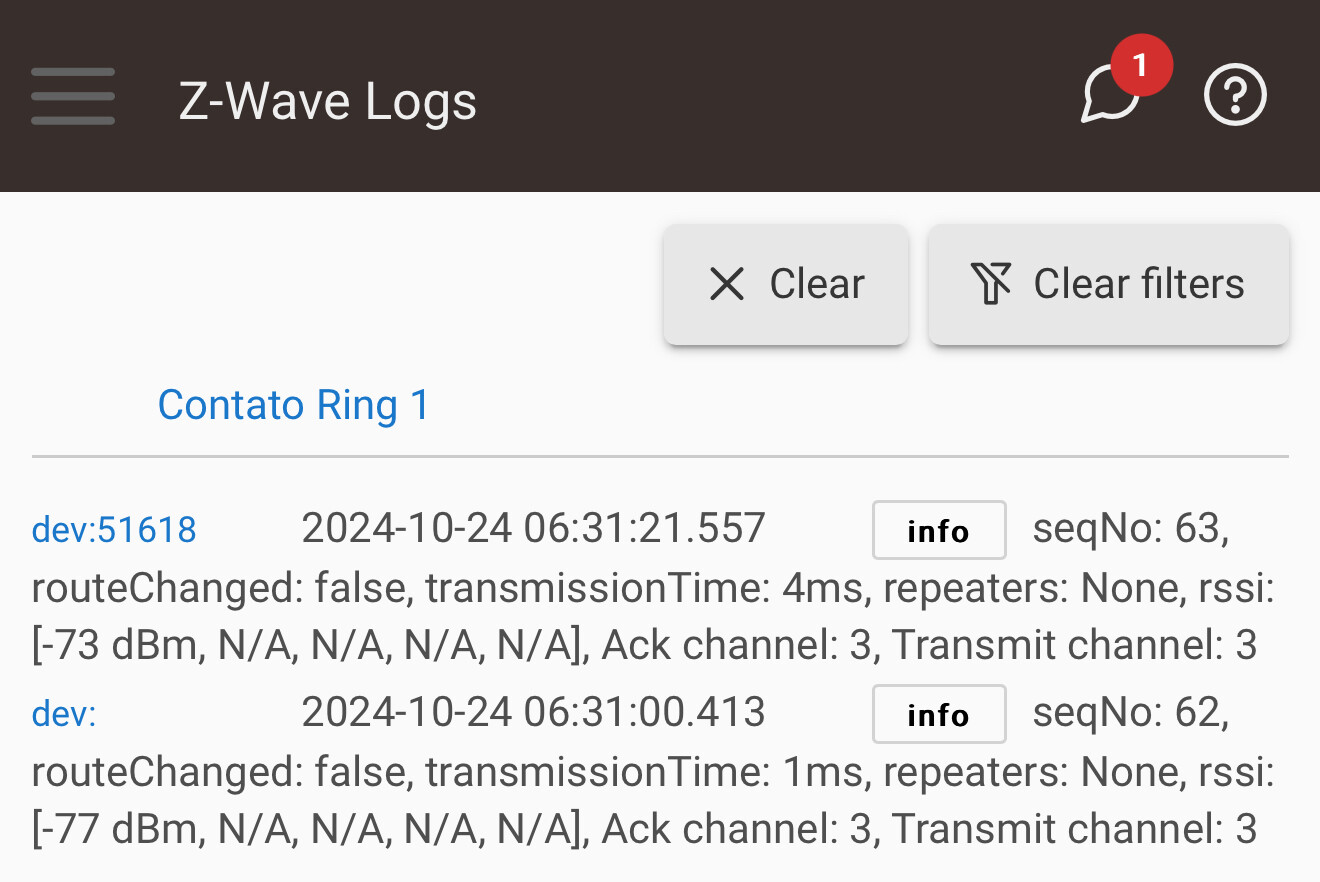

And here are the Zwave logs, interesting thing is that immediately after I open the contact I see the first log, but when I close the sensor I get the other line of logs a ~15 seconds later.
Not sure what its problem is. I don’t even see any contact open events? Do all the debug logs say closed?
I was hoping the delay on the response would make stop repeating and failing.
I’m guessing the device is expecting to receive some ack and since it doesn’t, it enters a failing state. The thing is that the device sends something when I open it (as per zwave logs) but we don’t see it on the device log even when debug is on… I guess someone else will join this thread so that I’m not the only one reporting this issue…
I think the zwave logs is outbound messages from the hub.
There should be a supervision response going back to the device, that is what I was adjusting. The hub takes care of all the acks so I assume those are going out.

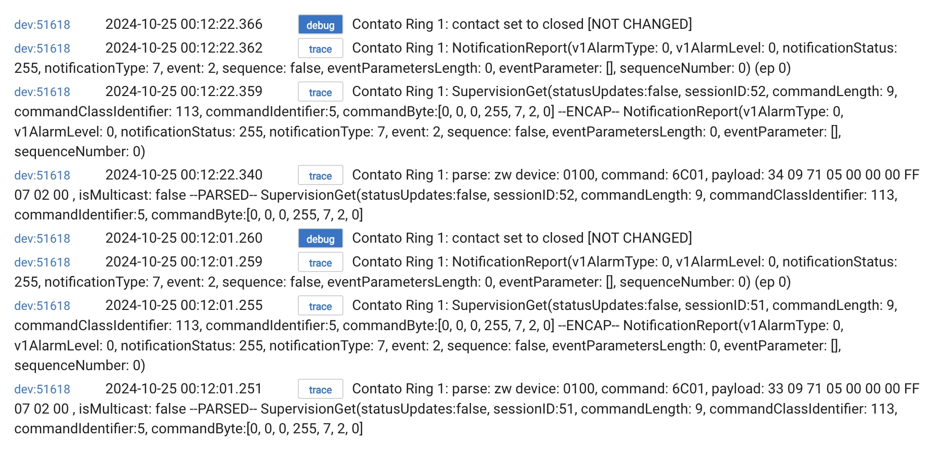

If you modify my driver code at the very bottom you can uncomment the trace logging, it will put more logs in but you would need to get a screenshot from a PC because it will be too long to see on a phone.

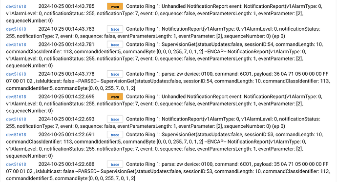

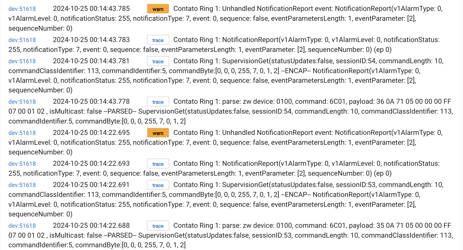

Actually, I just modified my code (same link) to adjust the response time to 300ms and also enabled the trace logging. That will show the exact message being sent when you open it. If you want to try it go for it.
You will need to tell me what log lines are for the open vs the close.
Ok I see whats going on. I forgot this driver was built for a device using some old protocols. I could fix it so that it recognizes the commands correctly but if the thing is still repeating and then going to a fail state that wont be fixed. I think my Zooz ZSE42 driver might actually work better. I will take a look.

I wonder if its mad because the supervision reply is being sent secure but 0x6C is not in the secure clusters.
Try this one, it still wont read the events correctly but my goal is to get it to stop going into the fail state and repeating itself. If that works I can modify the ZSE42 driver to get the events working.
