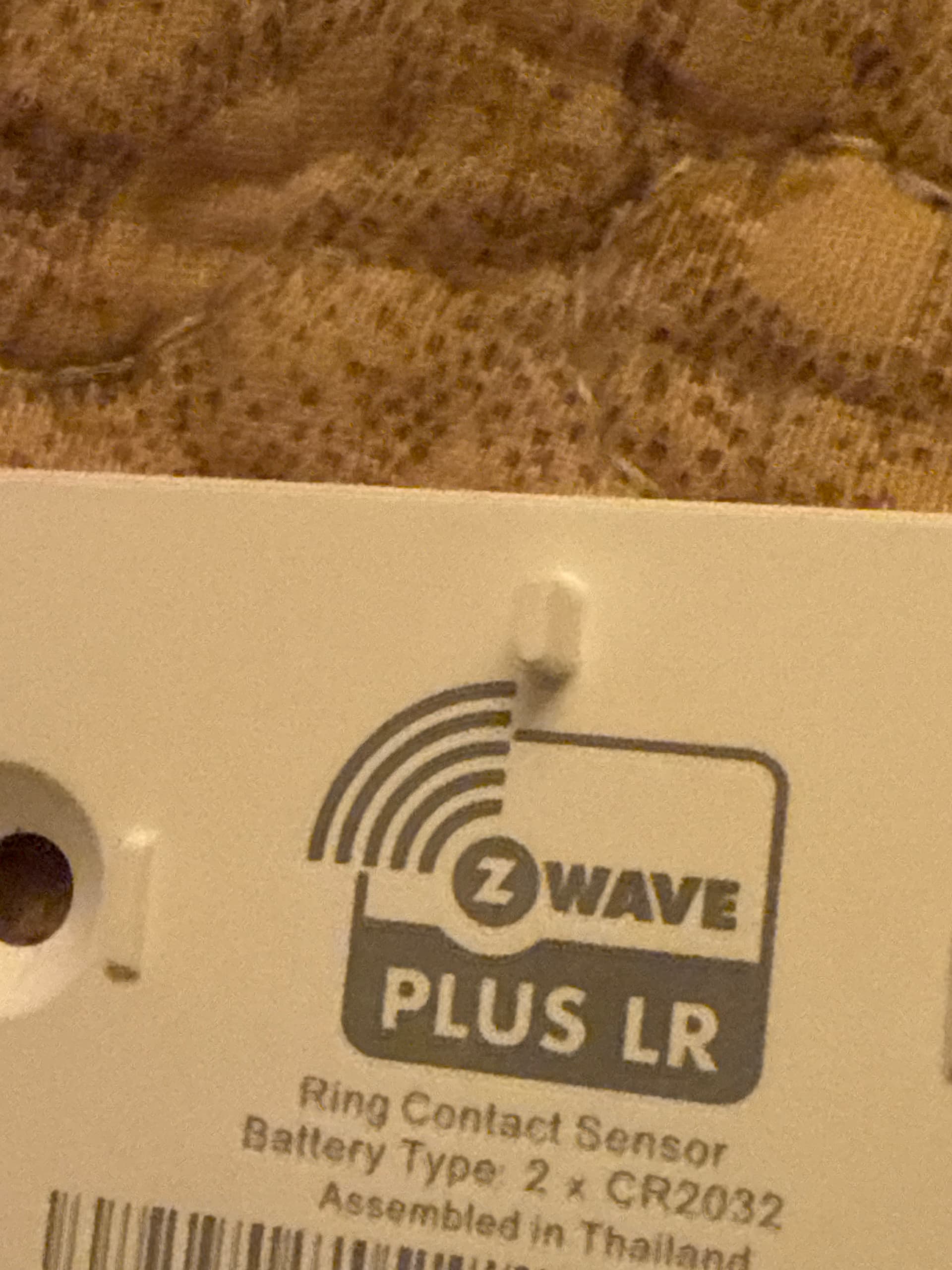

Ring Contact G2 is now Zwave Long Range
Model Number 5AT3S2
Well, guys, first time Ring Contact Sensor user here, looks like Ring updated them to be LR compatible and I tried pairing them with SmartStart and with the "classic" non-LR mode and the pairing process seems to be fine BUT after pairing the status open/close is not sent anymore to HE... Am I missing something or is there something "new" going on with the compatibility of these devices?

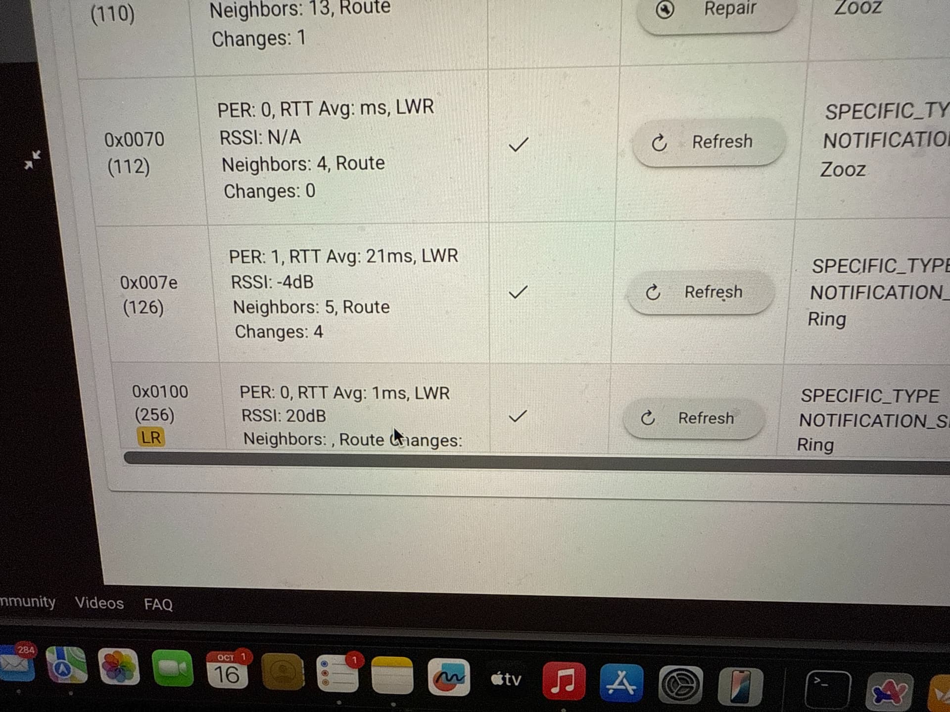

If you paired it via SmartStart, does the device's entry on your Z-Wave Details page identify it as LR, and does the entry look good otherwise?

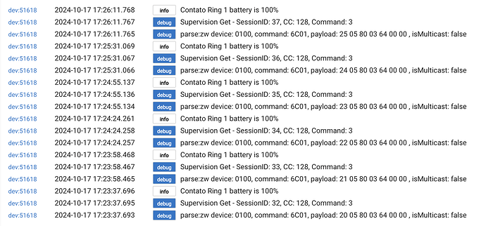

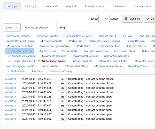

Here are the logs:

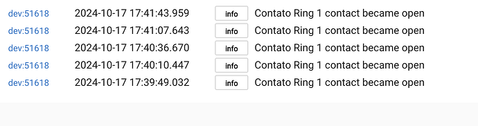

Looks like the open event is being caught but not the close...

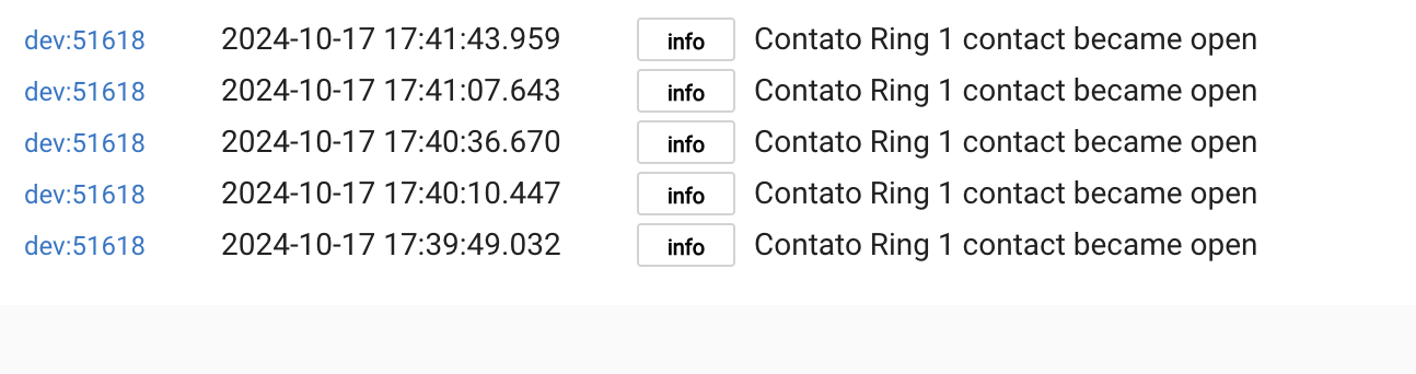

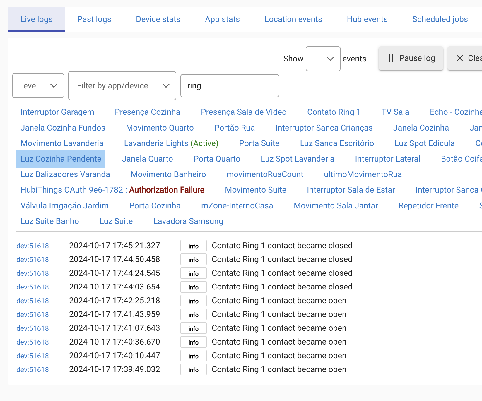

How fun this is? I opened and closed the sensor... But looks like I received a batch of opening then a batch of closing events... and looks like they are being received with an interesting delay...
I could make a good guess why, but it's hard to prove without zniffer logs, which requires additional hardware.
We'll see with Bryan says he's the guru.

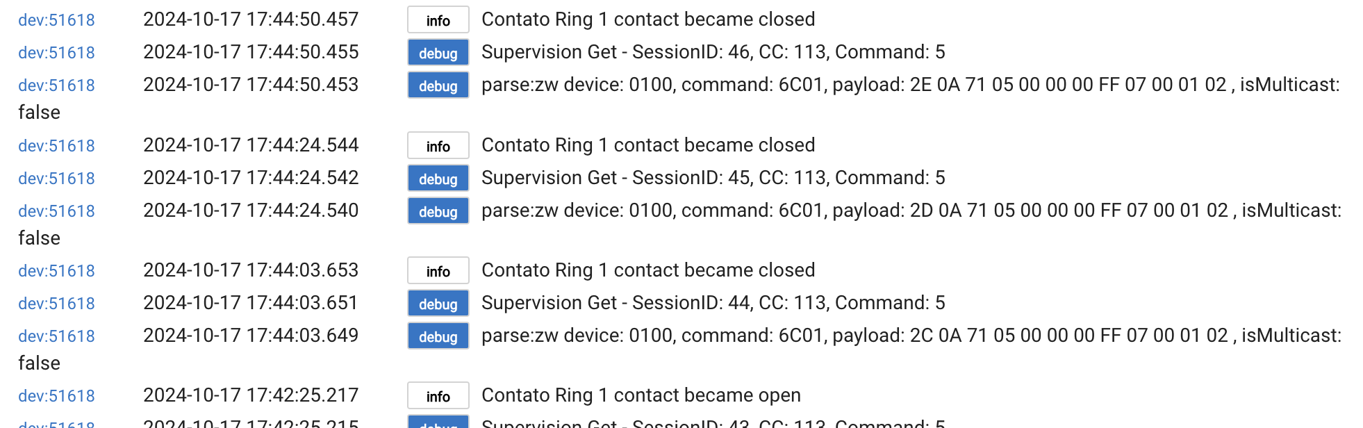

I would shut down the hub from the UI. Physically remove power for 30 seconds. Power back up. Wait a minute and try the test again and see if it does the same thing...
It appears that it's not seeing the supervision response.. :thinking:

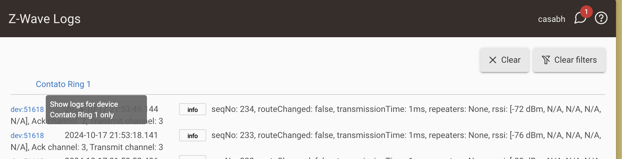

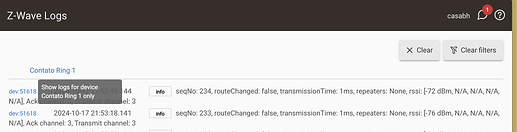

I'm seeing this on z-wave logs when I open the device:
Not to mention that the device blinks red once after some time I close it...
Bryan I had a ZCOMBO device I played around with and made a custom driver for. I found that I had to add a delay to the supervision acks in order for it to process them. If I sent the response immediately it kept sending the notification over and over until it tossed a system failed error back at me. I landed on a 500ms delay and it worked reliably.
	sendCommands(["delay 500", secureCmd(zwave.supervisionV1.supervisionReport(sessionID: cmd.sessionID, reserved: 0, moreStatusUpdates: false, status: 0xFF, duration: 0), ep)], 0)

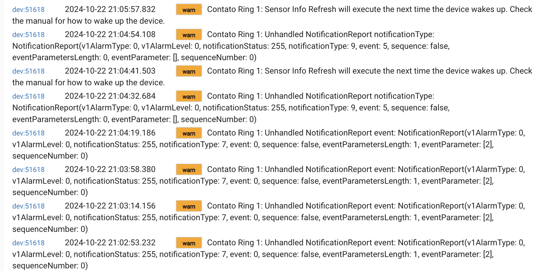

Still no luck with your generic driver BUT maybe these "unhanded notification messages" bring some light:
Is it still going into that failed state with the red flash? I was hoping the delay on the supervision replies would satisfy it. It looks like those first 4 log entries are all repeated retries from the device (it is a cleared tamper alert). Then the other two are heartbeats.
Did you activate the contact sensor at all during those logs? I dont see any contact open or closed events. Might need to turn on debug logging.
