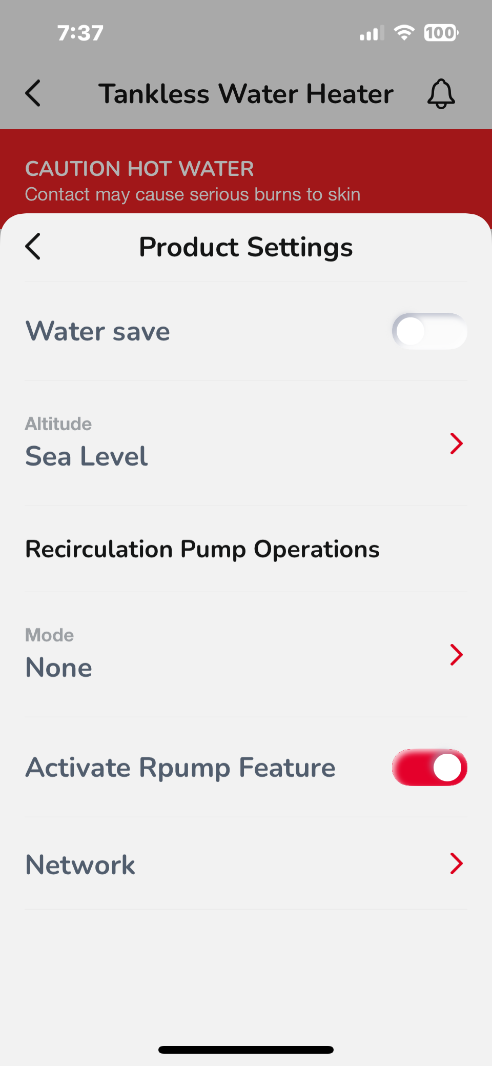

EDIT: Yes it is, but there are also different modes as well. I can set the mode and it would be remembered between turning on and off the recirculating pump, so I wanted to just control the pump's on /off.

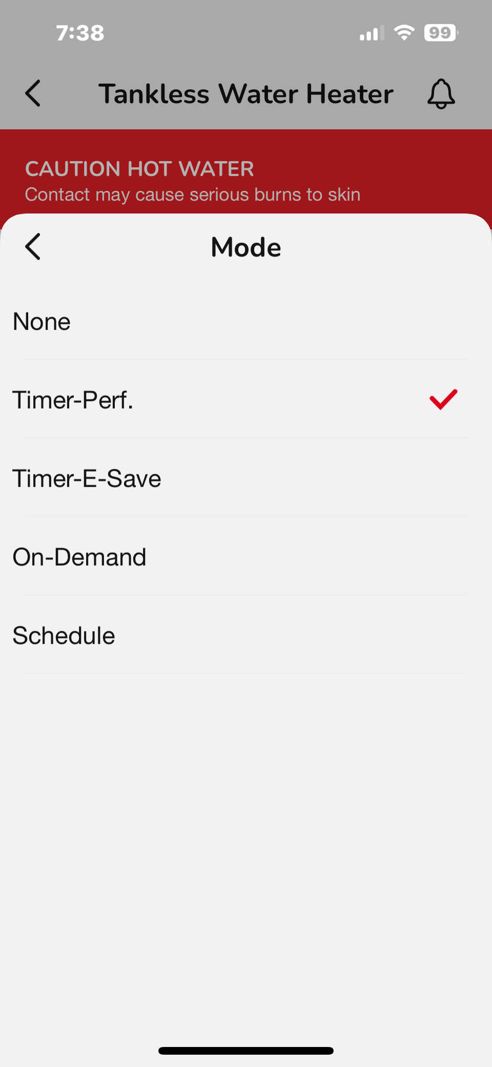

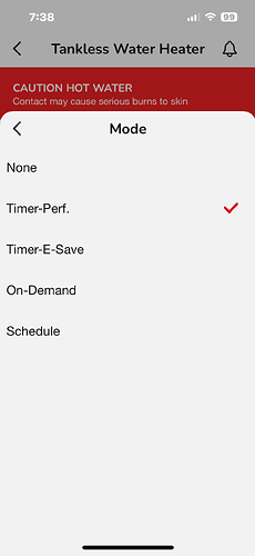

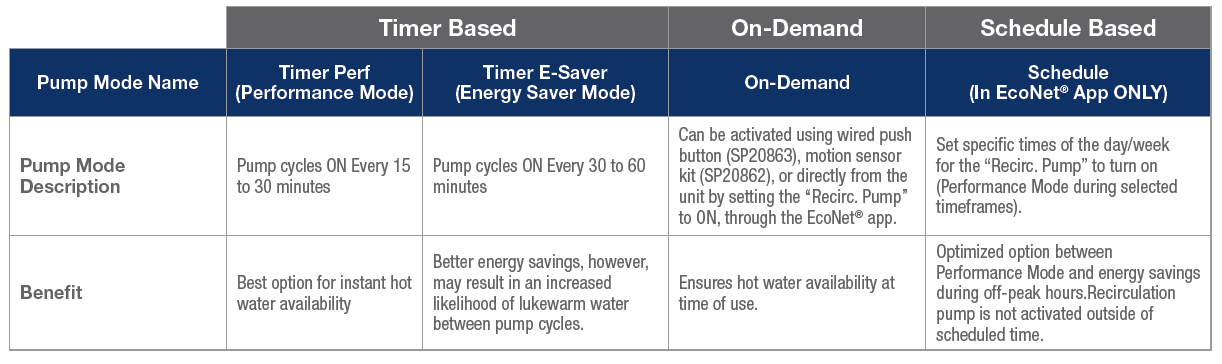

Here are pics from the EcoNet cloud app.
I’ll look up the description for each and add it below.
When recirculating pump is turned on, you must change it from "None", to one of these options.
I have been using the "Timer Perf" (Performance Mode). Unfortunately, that runs all day, whether the girls are home or not. If I could turn on /off the recirculating pump with a timer in Hubitat, that would be ideal. The schedule based option is not very granular. It's on or off 4 times a day with the heater itself. I'd like the recirculating pump to be off all day, except when the girls are using their bathroom, as they shower during specific times of the day (which everyone in the house was trained to do with the "Power Vent" NG 50gal. Bradford this replaced).

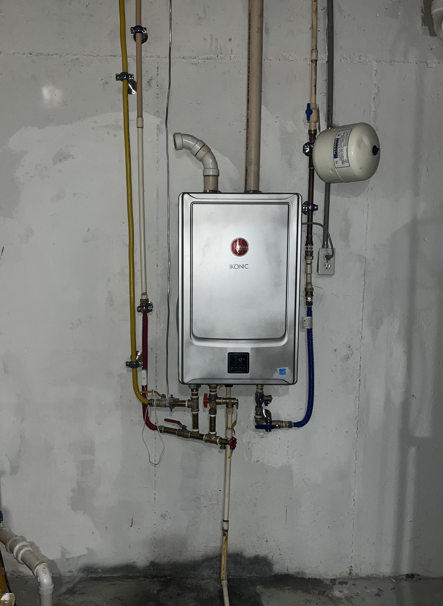

This is the new setup.
I could just hook it up to the bottom outlet in the pictured receptacle (that’s the one controlled by Hubitat), but I’m not sure how well this unit will take being completely powered on and off. There are a lot more PCBs in this and heating them up and cooling them down may start to break connections.
LOL, I just noticed in this pic that I forgot to put the leak detector wire back to the floor. At that height, there'll need to be 3 feet of water in the basement before it alarms.

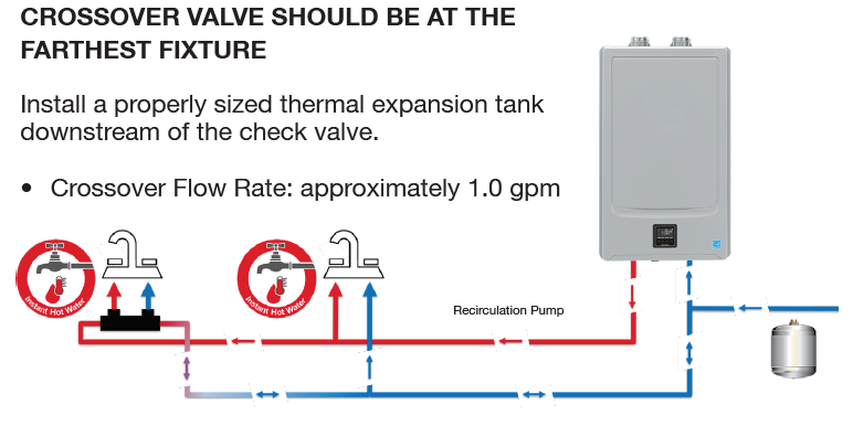

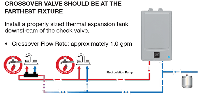

Though I do not have the return pipe setup for recirculation, this crossover valve was a part of this complete package, that uses the cold water side for return, for use when you don't have the third pipe design. I wish I would have known this was possible years ago. It would have saved me a lot of wasted water in the girls bathroom.

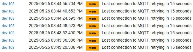

I noticed I was getting this in the logs
All I had to do was open the Rheem EcoNet Integration app on my HE and hit next. I didn't even need to re-enter my password for Rheem or anything. Is there a way I could easily automate this? Like using the lost connection as a trigger, waiting 5 minutes, and if the connection is still lost use a custom command to refresh the MQTT connection?

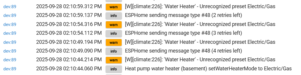

So, that being said, I got everything communicating with Hubitat and found one issue when sending commands to the water heater. Apparently the "Electric/Gas" mode is not recognized by the water heater. Attached is the log showing that.

I believe this is intentional on Rheem Econet's part. I remember reading in their documentation (can't seem to put my hands on it currently) that Electric/Gas mode shouldn't be used other than on an exception basis. Wonder if that's why...
