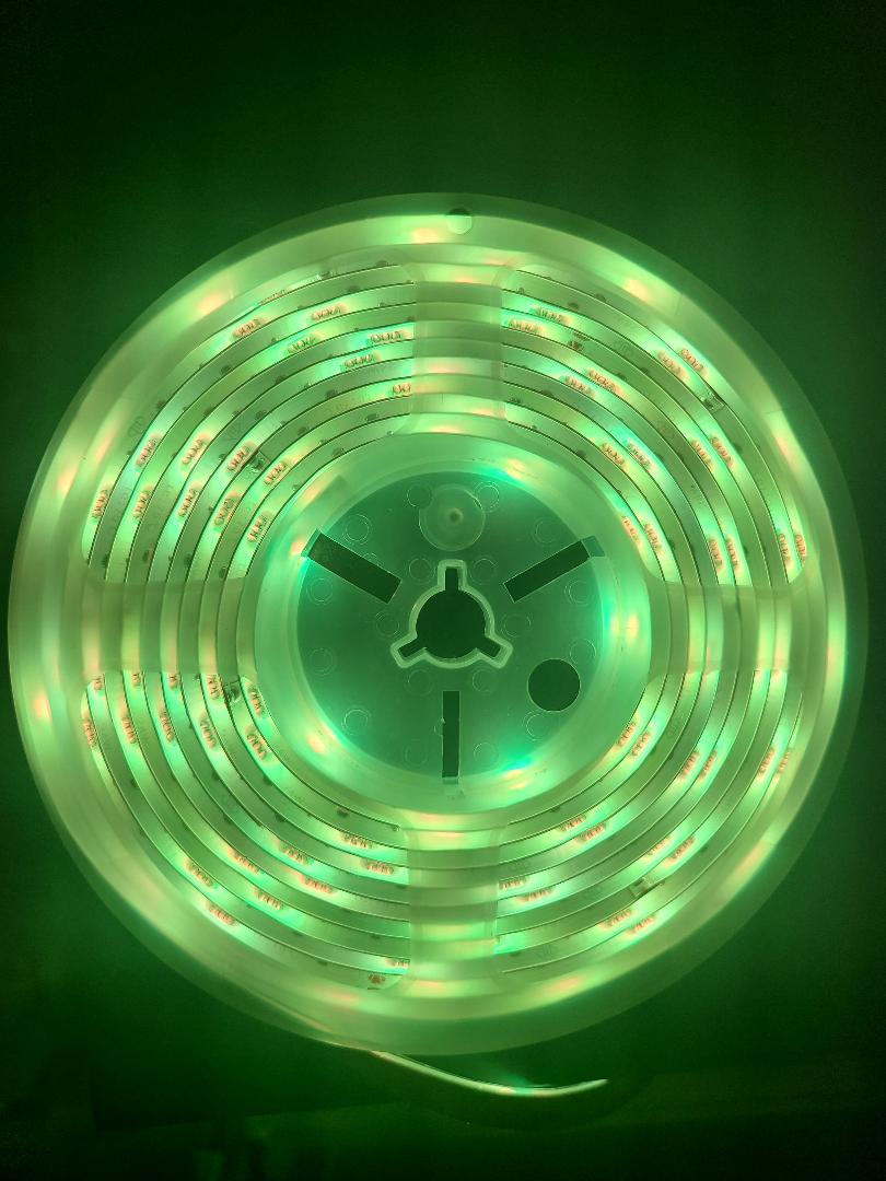

I'm using GLEDOPTO zigbee controllers. I should have included a picture. My yellow is straight up green. @Pantheon's lights look pretty green too tbh. I use a strip around my office door to tell me the temperature outside using a scale of deep blue (zero degrees) to deep red (> 90 degrees).
But you're right. Orange does look pretty yellow. Now I'll need to find something that looks like orange.
