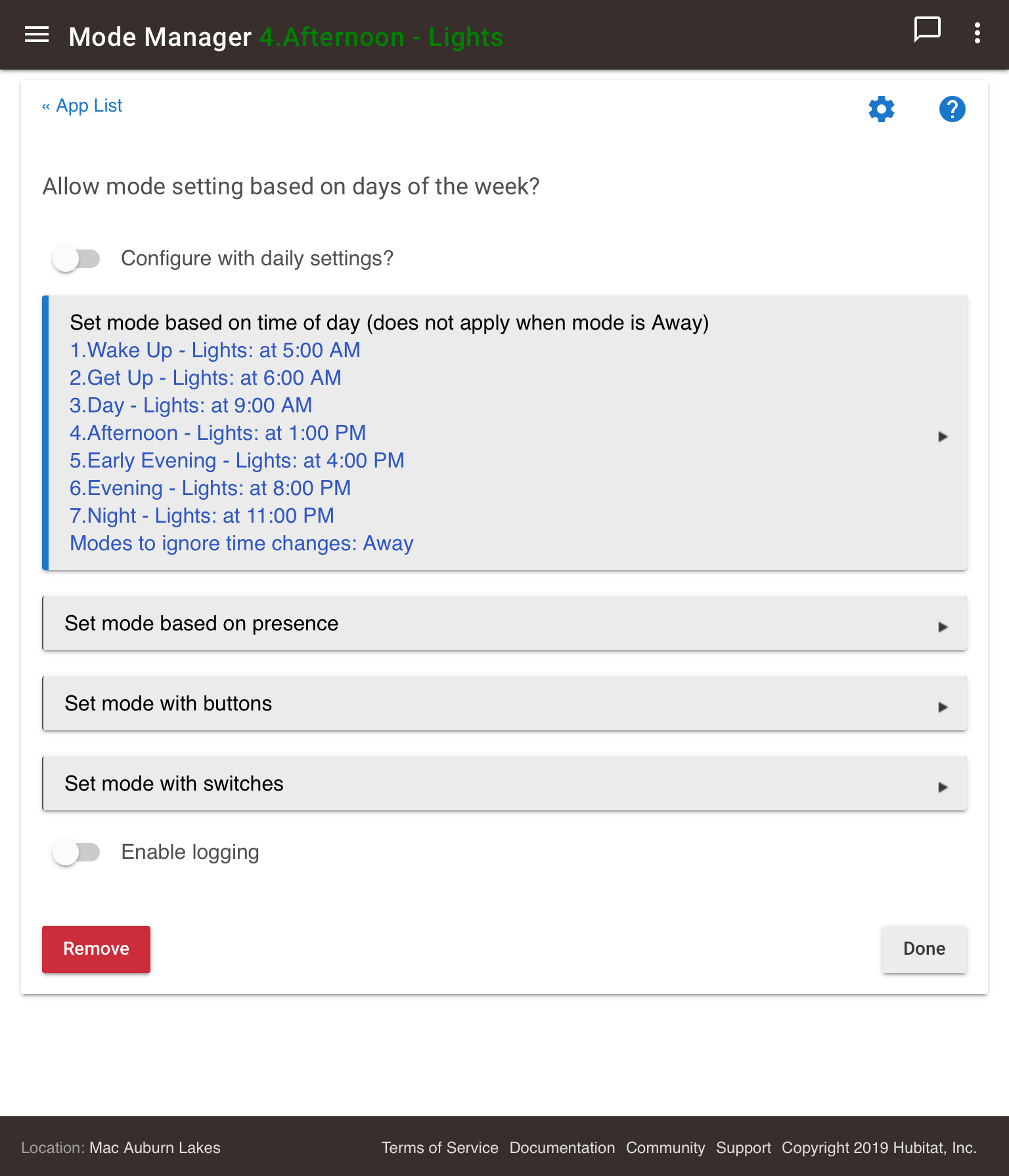

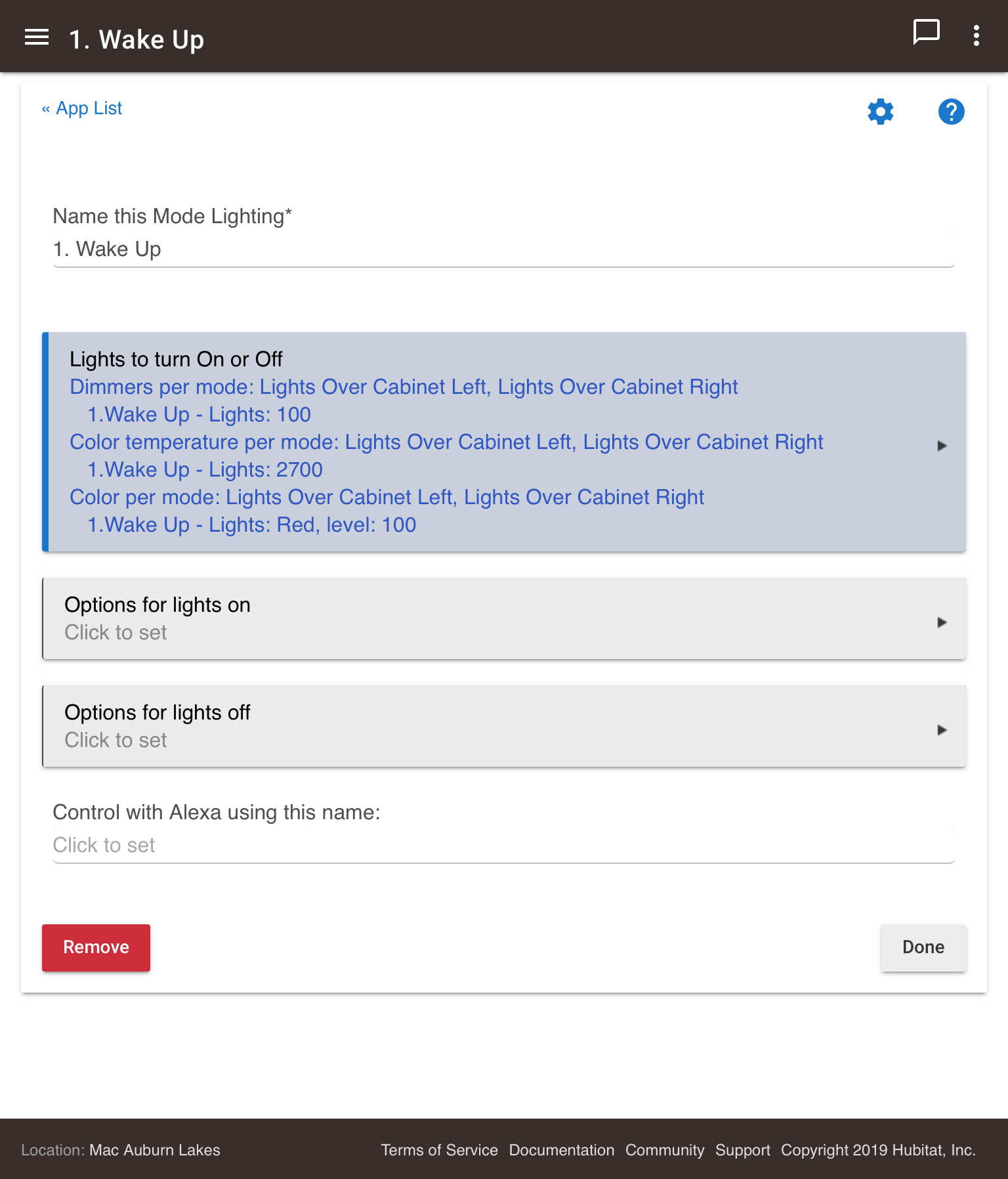

Interesting. I cant get the modes to actually change the light settings. Hopefully i add the pictures in the right order.
As noted earlier..i created 7 different modes in settings / location-modes.
Then modes to trigger based on time unber apps / mode manager.
Then setup 7 discrete lighting settings based on the mode
Then set up a dashboard to change the mode so i could troubleshoot and tune in colors.
The problem is the lights do not change color or brightness regardless of which more i set in the dashboard.

Looks like on your 1st screen shot you haven't defined what turns it on and off.
Not certain i had all the screen shots but they were all triggered by time. I ended up deleting all the commands and went with rule machine. Worked 1st try
