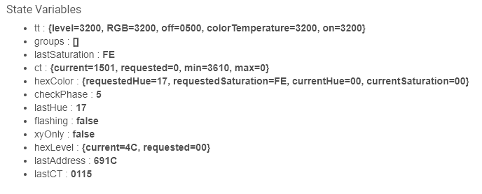

can you post a screen shot of the drivers state variables the data section?, thanks
