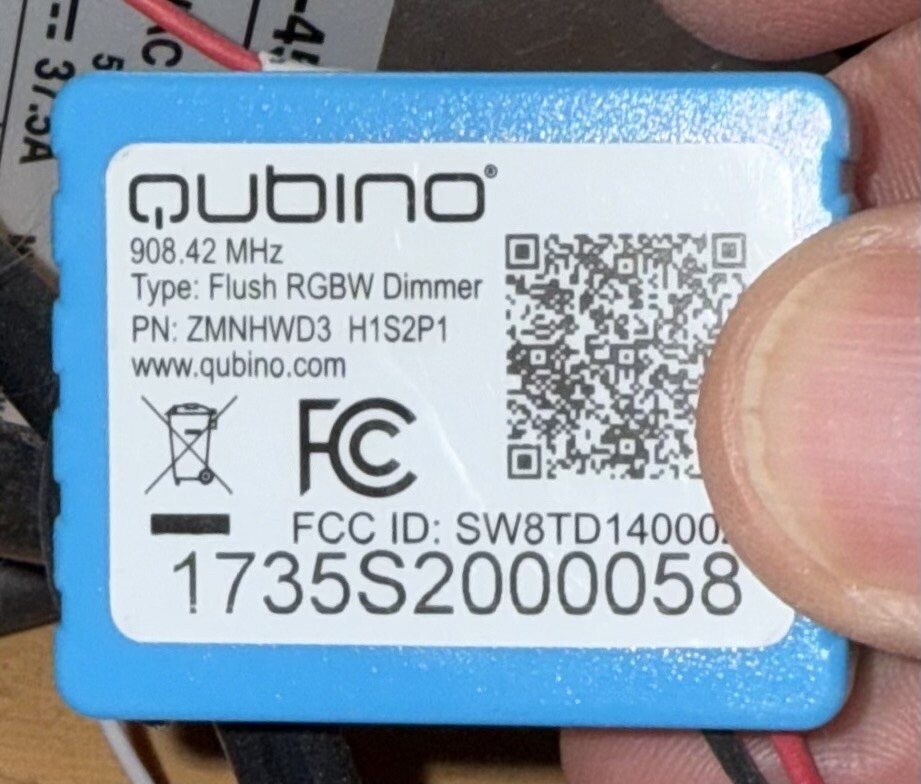

Thank-you, I selected a Fibaro RGBW driver and now have control. Now how do I set default levels for each of the RGB & W channels? At this point if I use the dashboard on/off it turns off on lights with ‘off’, but doesn’t turn all of them back on with ‘on’
Since your device doesn't look like a Fibaro, have you tried another driver like Generic Z-Wave RGBWW Controller? (I don't know what your device does for white channels, so this might not actually be the best.)

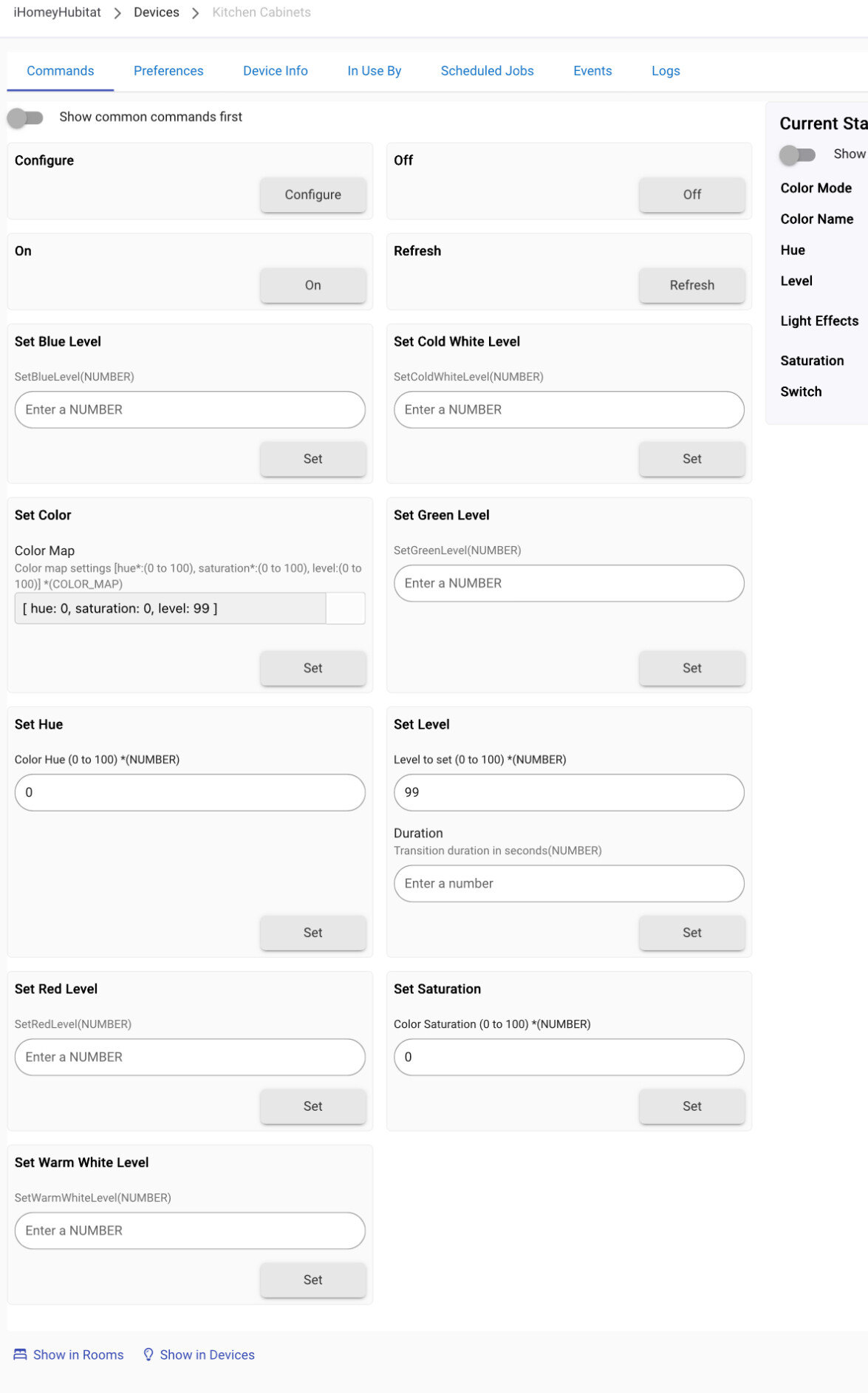

These are the available commands.
You may need to individually issue the commands to each channel (or set a color and then set a cold white level -- fewer commands for the same result), which it looks like are available, given the above behavior of color/CT devices.
Right! So, how do I issue one command that will set color to “hue: 0, saturation: 0, level: 100” and set Warm White to 100?
Any way you want to. :smiley: How is your automation set up now, e.g., with what app? The easiest approach would probably just involve a modification of that. But the per-channel commands are custom commands, so you would need something like Rule Machine, Button Controller, or a custom app.
