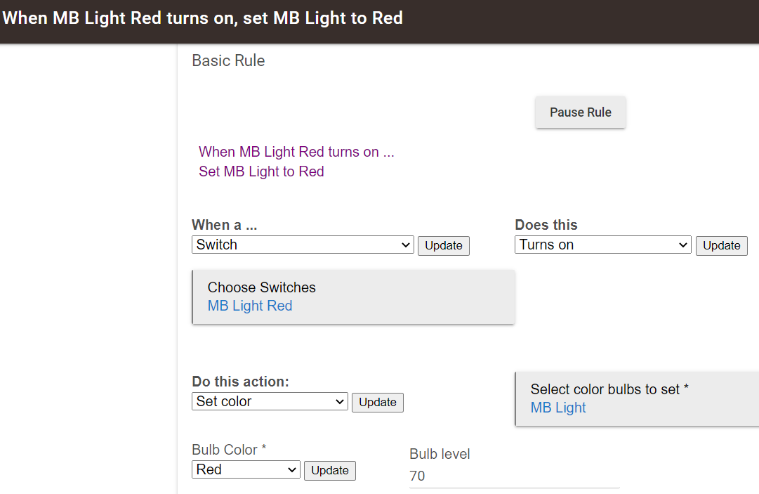

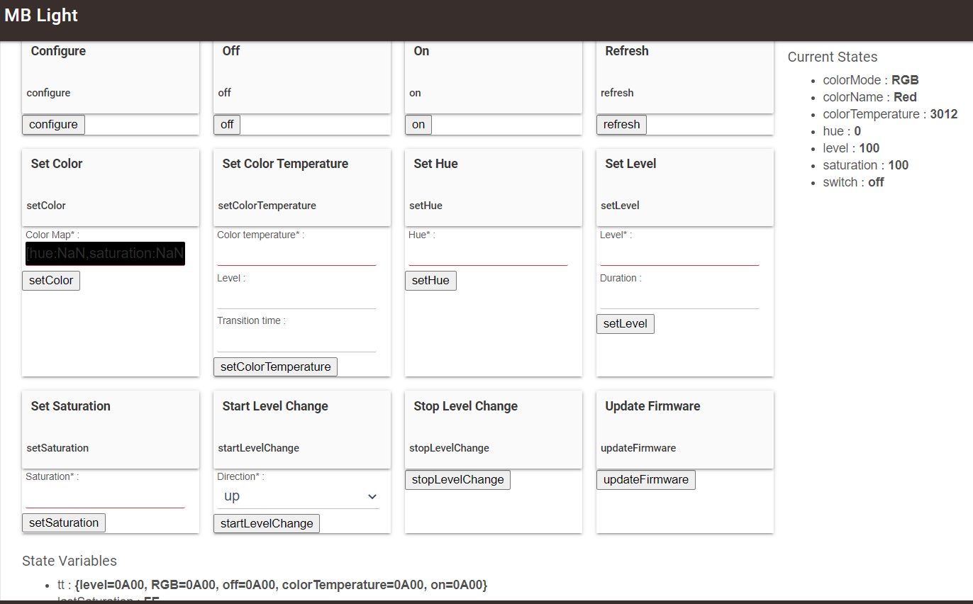

I recently update to 2.2.8 and noticed that my Basic Rules that were controlling them by setting color by name does not work any more. I can control the switch from the device page, and I can turn it off an on from apps. I don't see how to control the color by color name from the device page anymore. Only picking the color or setting the hue (0-100) or saturation (0-100).
This--hue/saturation/level--is the only way it's ever worked; some apps, like Basic Rules, provide color names for convenience (so you don't have to memorize hue values, I suppose). So, that's normal for the device page, but it's still odd that Basic Rule isn't working here.

I did have these Basic Rules working as shown when I first got the hub on 2.2.7. After I updated to 2.2.8 it stopped working. I've modified the Basic Rules to explcitly turn on the light device after setting the color, and it works now. I also had a rule that set the Kelvin temp and that one stopped working too. Explicitly turning On the device after setting the color temperature fixed that one too.

What driver are you using for these bulbs, and what kind are they? It sounds a lot like you may have enabled the "Enable color prestaging" preference found in some bulb drivers, which works exactly as you say (a "Set Color" or "Set Color Temperature" command will not turn them on; they will require an explicit "On" command afterwards but will turn on to this color/CT, whereas conventional behavior is for a "Set Color" or "Set Color Temperature" command to also turn the bulb on if it is off).
If that doesn't explain it, try hitting "Configure" on the device page to see if that helps, particularly if you've switched drivers lately (but it can't hurt regardless).
I believe they are OSRAM Lightify RGBW Zigbee smart bulbs. The driver is Generic ZigBee RGBW Light. I have not changed drivers and don't think I have changed settings. Just updated Hub firmware.
Just noticed that Color Pre-Staged is enabled.
That explains the difference, then.
