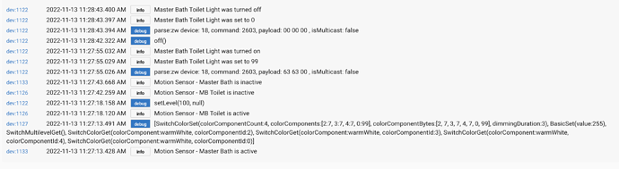

  5. It's hard to tell, when I see issues with other devices its a combination zigbee/zwave. zigbee motion sensor controlling a zwave switch.
  6. See below. It looks like thehub received the zigbee motion alert right away, but it didn't send the "turn light" command for 37 seconds.
