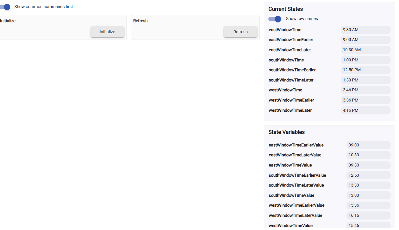

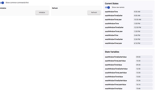

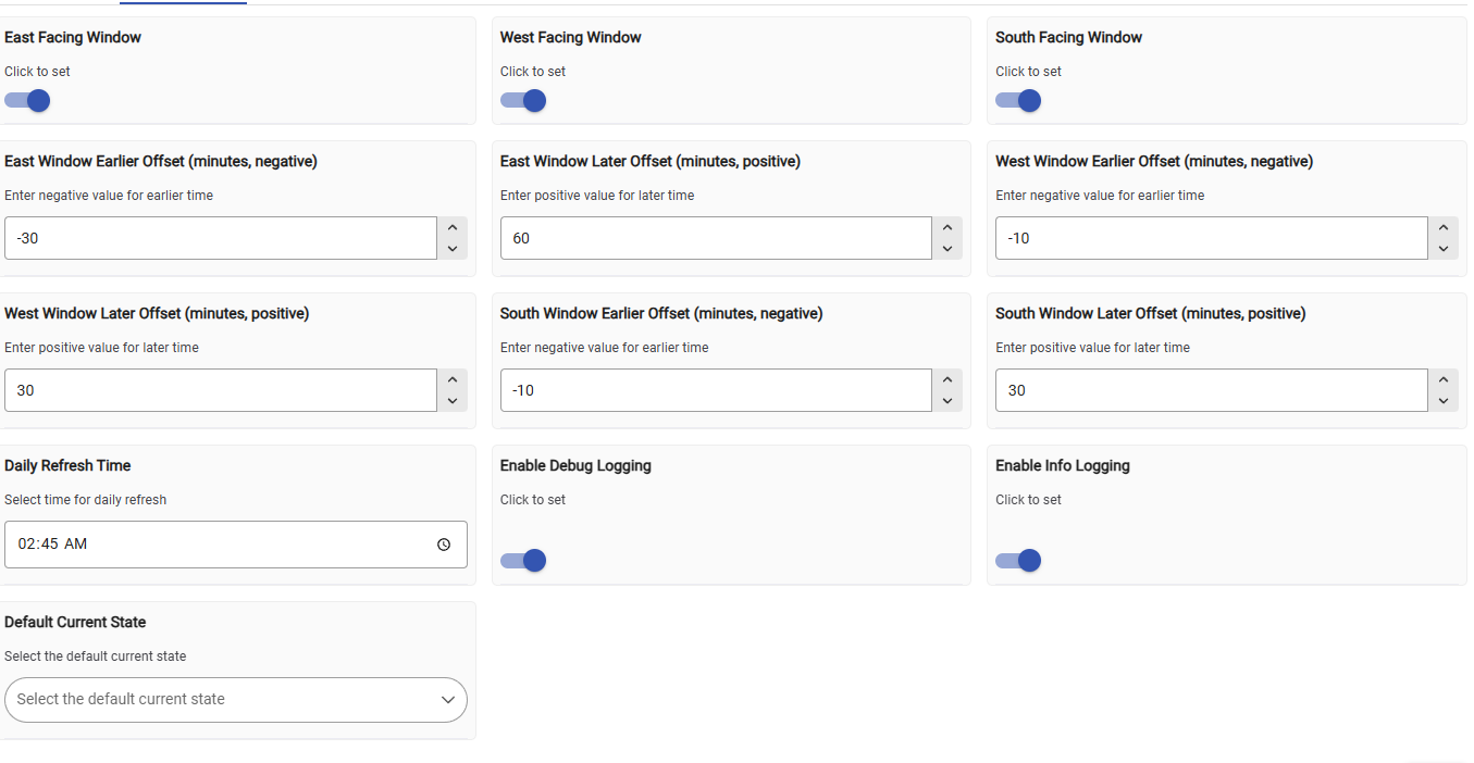

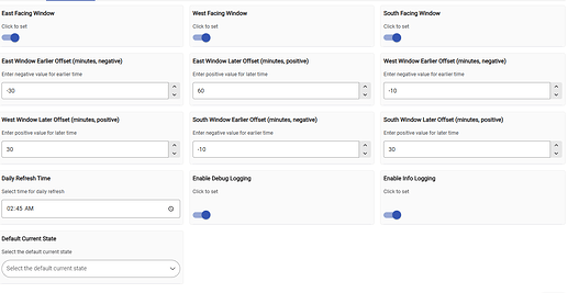

I would be interested to see what you have. I used AI to create a driver to find peak window sun time, and some offsets to use as triggers for rules. It sorta works, but I am sure it could be cleaner. I hesitate to publish it because being AI, it probably ripped off everyone on this forums code and there is no way to properly attribute anyone that the AI stole code from.

My use case is to calculate the times once a day and use Schedule Manager to set the shades. It is cleaner and easier to see all of those times in Schedule Manager for all 9 shades than to have the same thing in the Shade Height rule for each shade. These rules keep the sunlight within a certain distance of the window.
Already have several time variables that are set daily just after midnight. This would add 6 more. 2 each for East, South and West windows.
Additional bonus is that I can use those times to start and stop the Suncalc and Shade Height rules.
