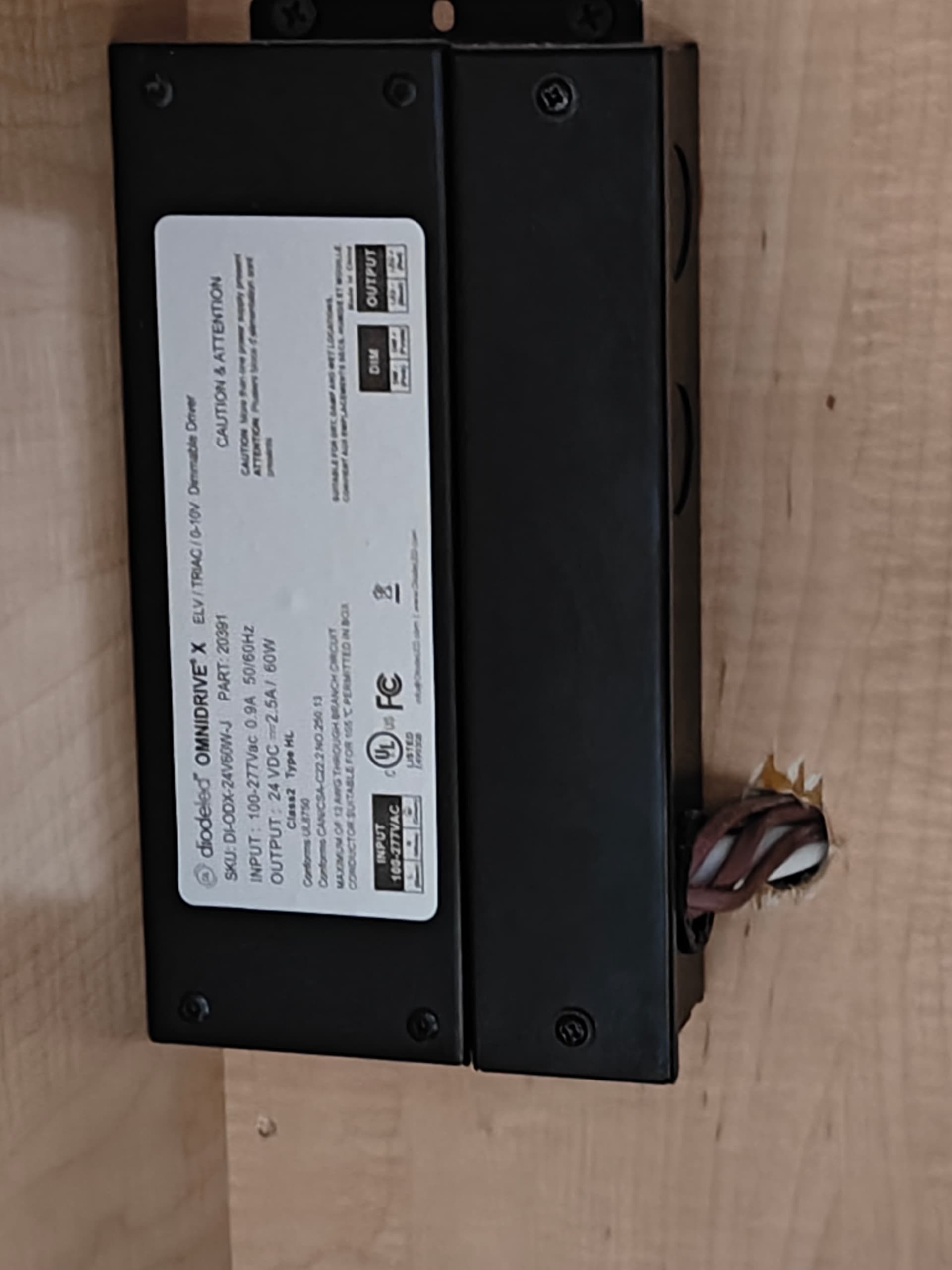

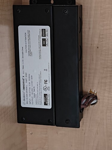

There's a switch/dimmer on the wall, which goes to this under the sink:
From there, the brown wires go to four segments, I think.
Yea.. so that is a 24v system. What you could do is get a few Gledapto zigbee controller. They have terminals for 12-24v input. You would need 4 of them as you would need one at each section. Then get a valid LED strip for each one that has the needed wires for the controller based on the controller type and strip type. Make sure the strip is designed for 24v as well.
The downside is this would remove the switch from being a controller, so you may want to remove it from the circut and possibly replace with a switch that can function as a virtual switch like a Zooz Zwave Switch.
Yes, the switch I gave them is a Zooz dimmer, so that's workable. Two of the spots are exposed enough that I'm not wild about having the controller exposed, but better than being unable to do it at all, I suppose.
Yea.. the other option would be to try to change the wires. Technically if you went RGBIC you don't need 4-6 wires. You just need 3 i believe. DC+, Ground, Data. The problem is i am not sure how well the D wire will translate to 4 locations.The D line needs to be a continuous series for the IC functions to work.

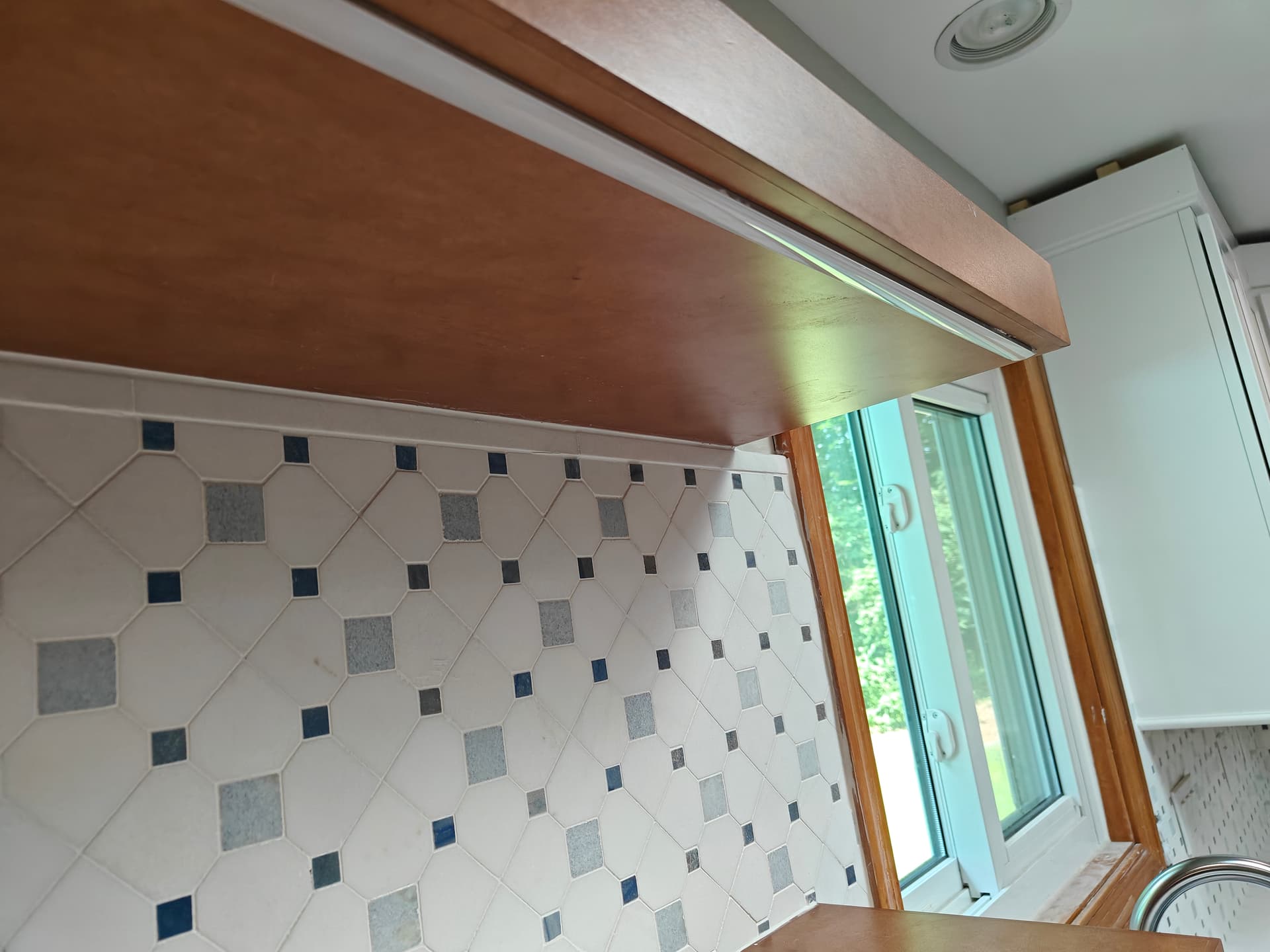

Here's what's in currently β€” the 24V wire runs through the shelf, which looks pretty slick. Unfortunately, there's also very little slack to work with on it.
