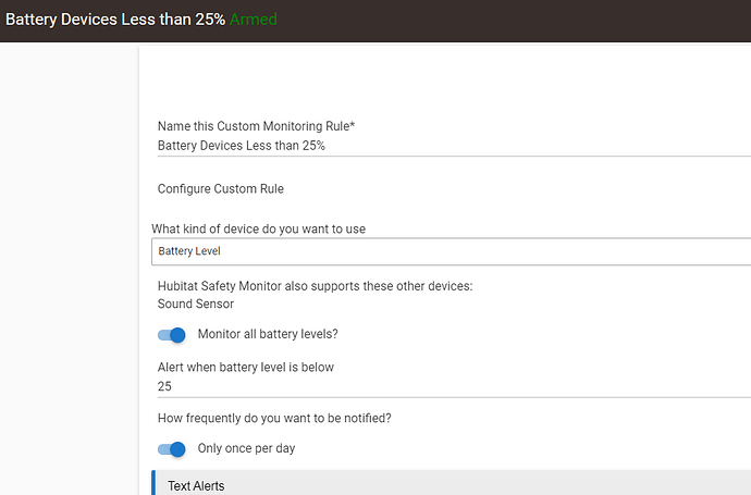

It can, simply use the battery attribute of the device in the tile. That said that can be pretty costly in rendering on any dash system. You're better off simply using HSM to monitor all your battery stuff with a threshold of 15% to send you a notification of when they need to be changed. Combine this with Device activity check to monitor if anything drops off the mesh, you don't have to worry about watching the battery levels. The reason I recommend 15% is that battery levels on all devices lie more than your ex getting caught with her/his pants down. And like your ex or mine, they are just not reliable in how they tell the truth about actual battery levels. Especially if you are using lithium ion batteries. Those will report 100% right until they die. So both options above are your better bet for monitoring battery levels and checking for stuff dropping off network.

And, is there a way to create one rule for all battery devices to notify me when the battery level goes down to 20 on any device? If so - should I use rule engine, notifier app or sth else?
Would really love to NOT create a rule for each device separately
This is a custom alert in HSM:
